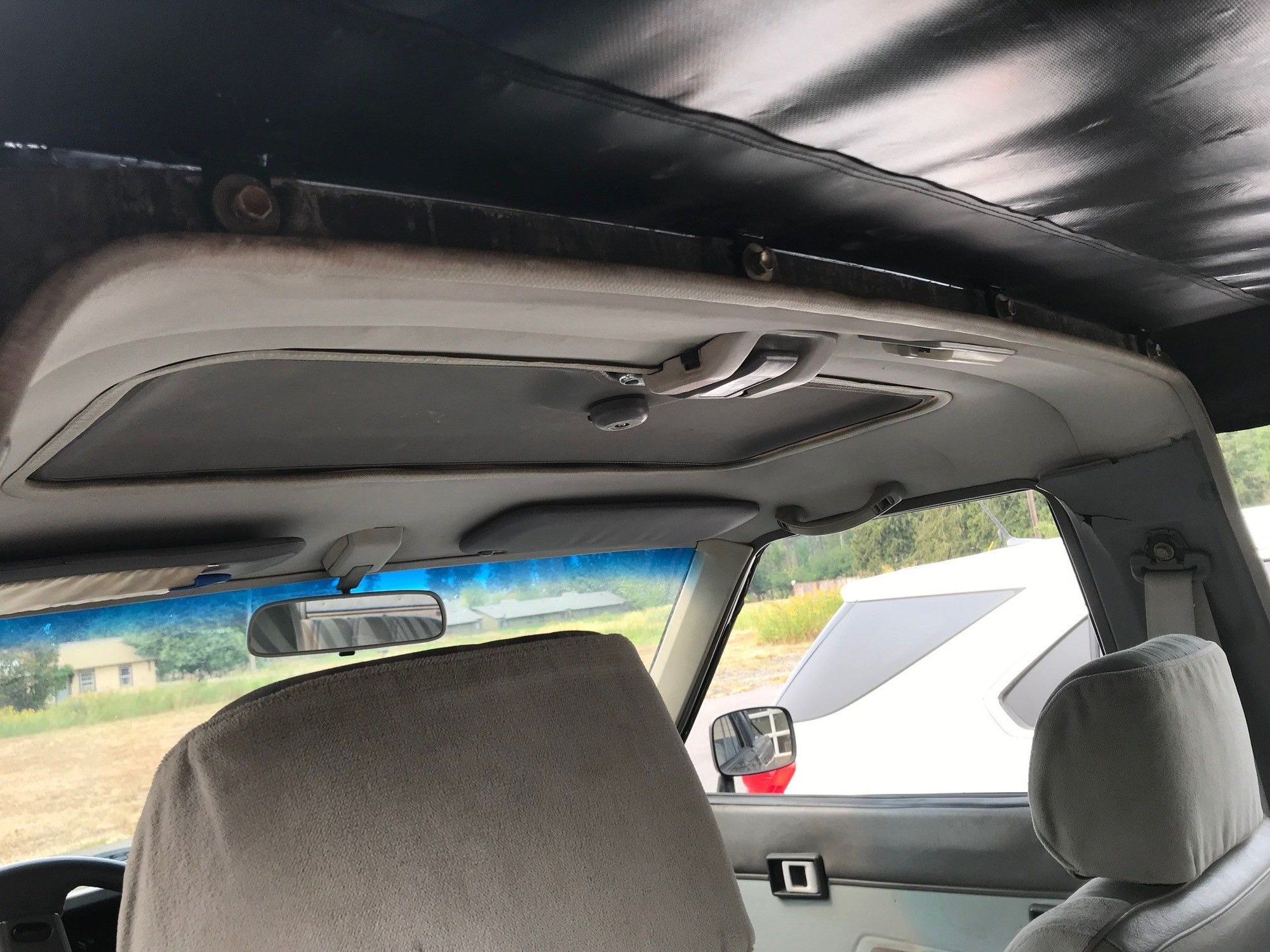

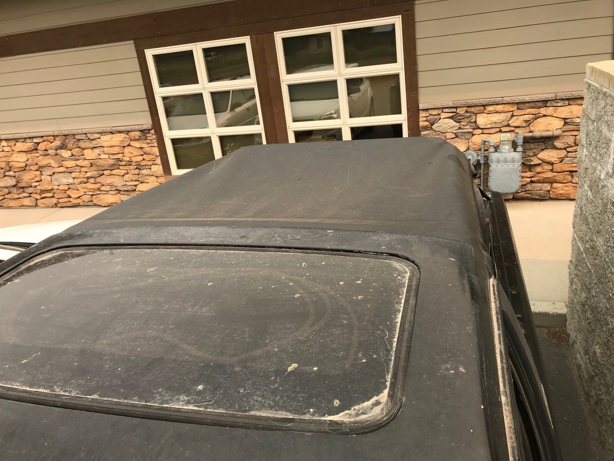

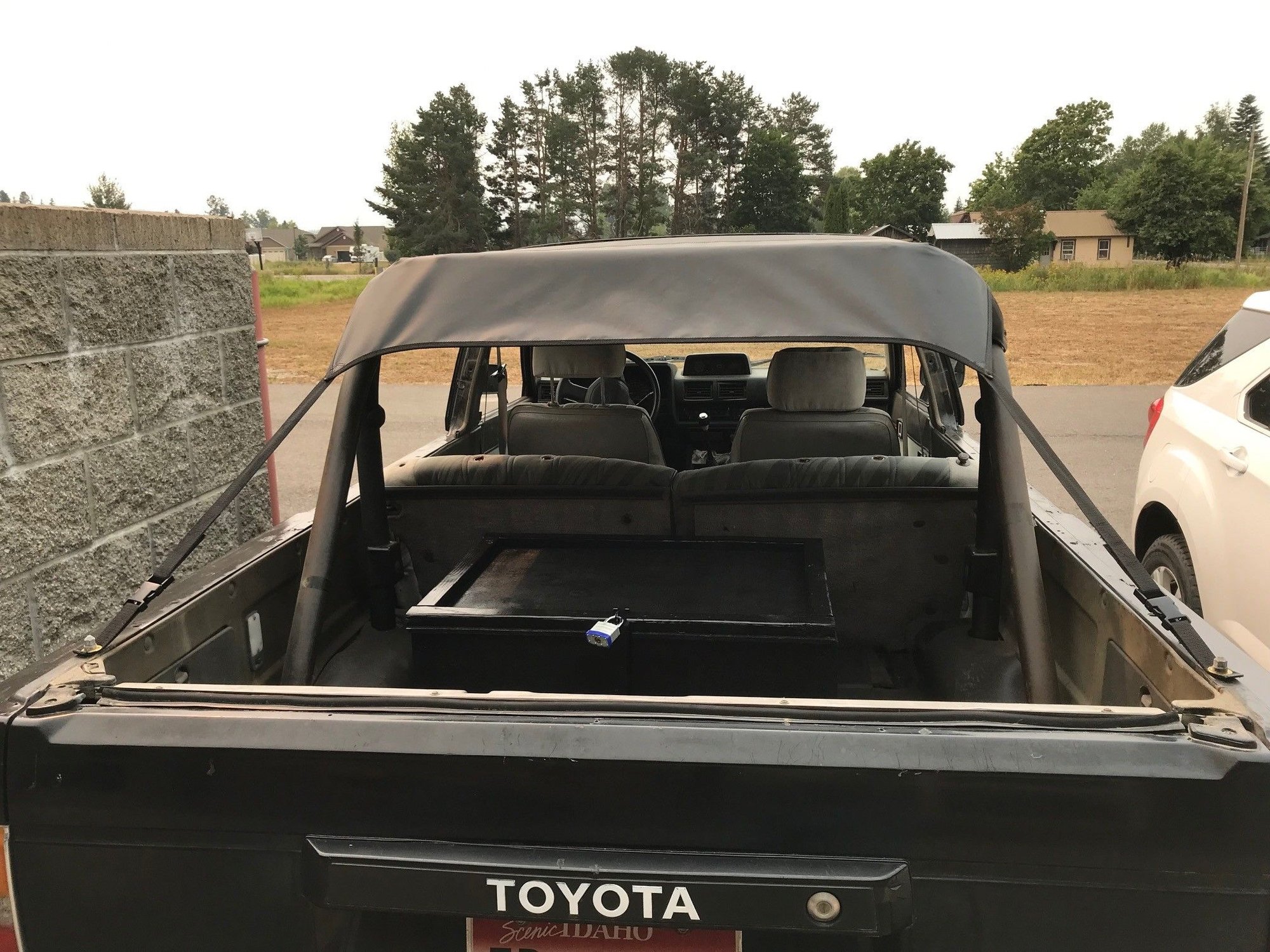

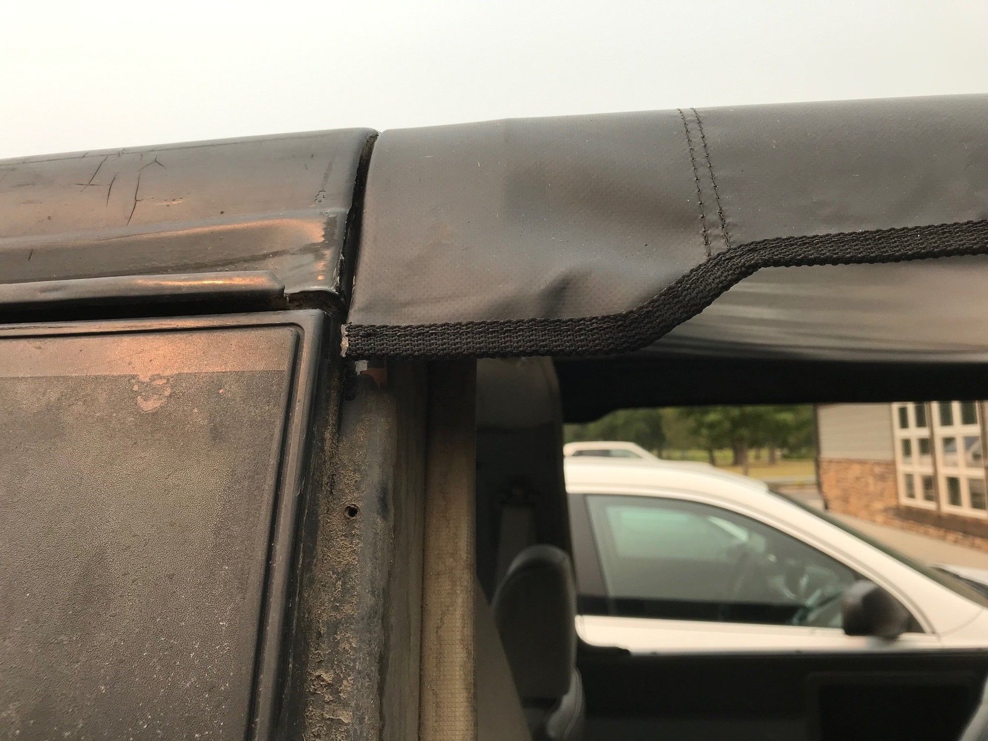

Overall very impressed for the price point and simple installation. No instructions were included but it took 30 seconds to see how it attached. Took me maybe 10 minutes and that was just because i had just barley removed the top, opened the box to make sure it looked right.
To mount it: Use the top row canopy to cab bolts to mount the top bracket that's sewn into the top get them aligned and not tightened yet. Then I stretched the bikini top over the top of the rear roll bar and ran the support straps to the hole on each side used to mount the top. Made sure it looked right and snugged the bolts and after a few days in the sun tightened up the two rear tension straps just a bit. The tension straps even have Velcro backing for extra tension protection. If the top ever tore I'm confident I could have a copy made locally or if LCE would sell just the top (doubtful as its sewn around the mounting bracket. The bracket is nice and painted black and was a perfect fit to the cab body with no bending or forcing to align holes.
You still need/want the seal between the top of the topper and the cab (waiting on mine from softtopper there adhesive bulb seal) and there is some sag in the middle between the mount bracket and the rollbar but honestly cruising at 55mph I didn't hear any flapping so I don't consider it a problem. You'll notice I used the wrong bolts to mount the rear tension straps. I got it fitted and just left them there. Its cheaper than building a DIY one using the cj7/8 or trying to stretch a wrangler one and honestly just a good product.
