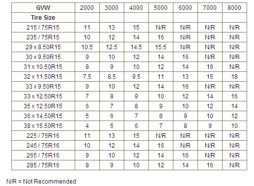

See the attached diagram that is commonly passed around for a good target pressure for general offroad use.
