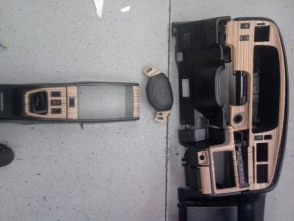

“I did not do the camo, but I did wood grain and black. The stuff is easy to work with. A heat gun is your friend as well as keeping all the surfaces clean. The black vinyl is so thin that the dash texture comes through.”
Toyota Truck Vinyl Wrap
He’s also kind enough to share some detailed tips to anyone looking to wrap parts (or the entire body) of their own Toyota truck.
“You’ll want a very sharp knife. Or, if you can get your hands on a scalpel, those are the best for trimming the hard areas like the speaker vents and edges. It is hard to trim a strait line, so I used pinstripe tape dropped on the ground to make the backing not so sticky and used that as a guide.”

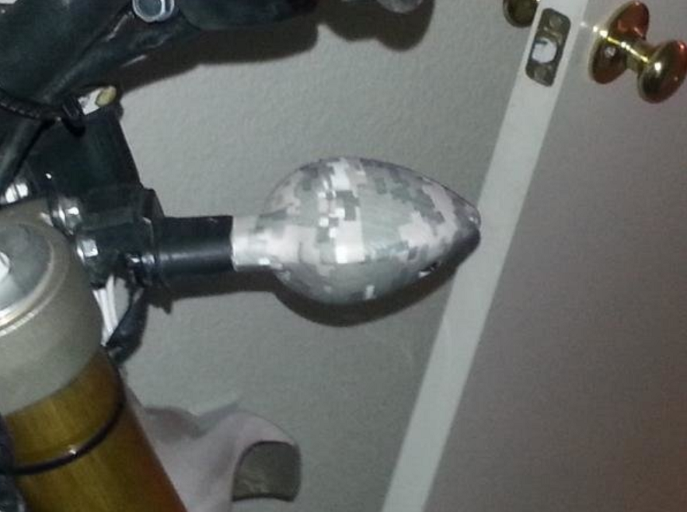

“For the money, hydrographing would be a lot easier, look better, and is less than $100 for a DIY kit. I’m going to hydro dip the dash in my first gen in camo, because after 5 years the vinyl looks like poop and is peeling by the heater vents. Check out YouTube videos on it. It’s an easier process and way cleaner.”
