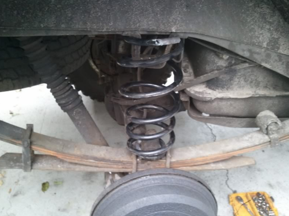

“After being a fan of the site for quite some time and reading other’s successful stories, I decided to do a Zuk mod on my ’86 4Runner SR5. When I bought my truck it had 3″ blocks in the back and the torsion bars cranked up to fit 35s under it. I previously added the ball joint spacers so I could smooth out the ride up front. But I was still breaking u-joints, and had a low weight capacity for towing and payload.”
Toyota 4Runner Zuk Mod
Prior to starting the mod, the OP’s rear leaf springs were flat as a board.  Thus, this made his 4Runner a perfect candidate for the Zuk mod. It’s a rather simple and ingenious idea, one that even folks with little mechanical know-how can perform with no problem. First, he simply supports the axle and removes the leaf spring u-bolts.
Toyota Zuk Mod
“My bolts to the leaf spring hangers didn’t really want to come out. So I improvised to get some extra room in there. I used stock Jeep springs from a friend’s Rubicon. There are two lengths and diameters under those Jeeps. Luckily, the shorter and wider ones pretty much fit perfectly around the bump stops between the leaf and frame without any problem. I used a torch to slightly bend the ends to better fit around the stops.”
Toyota Zuk Mod
“I recommend the Zuk mod for any older Toyota, especially the 4Runner. After putting about 5k on it since this mod, I can say my horrible body roll and constant fear of flipping while turning is gone. The Zuk mod stiffened up my rear end so much I can load my truck with tools and have four guys stand on my bumper and it barely drops with all the weight.”
