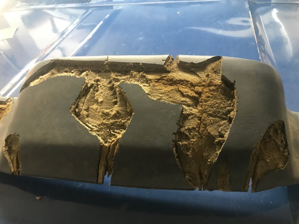

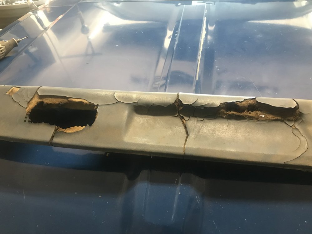

The OP opened his thread with an explanation of what he was dealing with in his 1982 Toyota pickup. This first post also included pictures of the rough shape of the dash cap.
I recently picked up a rough but not rusty ’82 4X4 with the intention of a full restoration on it. I want to drive it some to work out the mechanical bugs but thought I’d tackle the really bad dash. I recently restored an ’86 IROC and did this with the dash too. Turned out great but this dash was going to be a challenge since the Camaro dash is almost completely flat.
So here goes…This is what I started with.

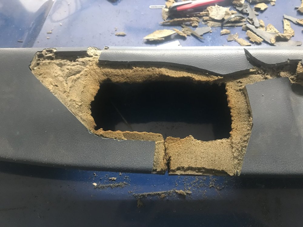

As you can see, the plastic is cracked and peeling while the foam is wearing away as well. It is particularly bad around the speaker opening.
Cleaning Up the Damage
The first step after the dash was removed from the 1982 Toyota pickup was to clean up the damaged areas. The OP trimmed away all of the damaged plastic and smoothed out some of the old foam.
Toyota Pickup Dash
Toyota Pickup Dash
Toyota Pickup Dash

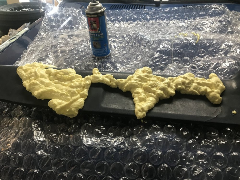

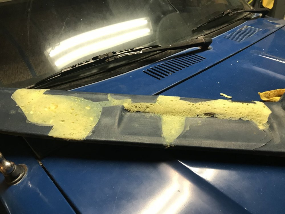

Next, since the OP didn’t plan to use the center speaker opening, he covered the hole from the underside. With that opening filled, the OP layered down a generous portion of spray insulation foam in all of the damaged areas.
Toyota Pickup Dash
Toyota Pickup Dash
Once it was dried, he cut away the excess, recreating the factory shape of the dash, sans the speaker opening.

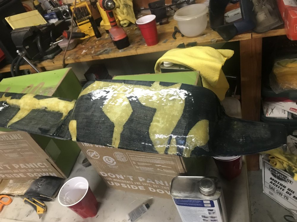

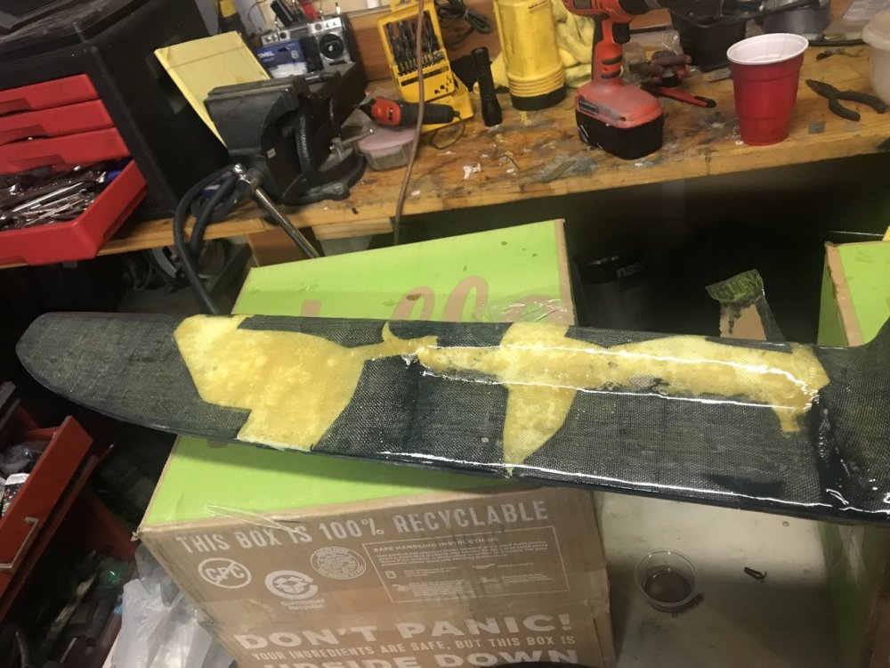

Once the cracks in the plastic was filled with foam, the owner of this 1982 Toyota pickup created a more uniform cover with some quick fiberglass work.
