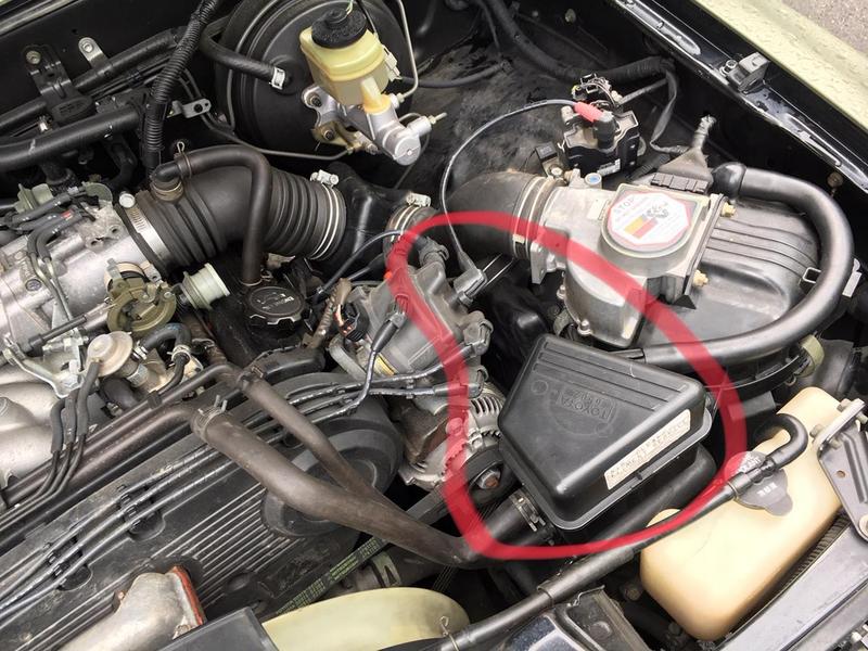

“I know there are a lot of ISR mod threads out there, and I’ve read a lot of them. Most things are clear to me, but in the pictures I see, there is no sign of an EGR box anywhere to be found anymore (marked in red in the picture hereafter).
Now I see that there are two lines going into it, and one line + 1 ‘pipe’ coming out. If I were to do the ISR mod now, I would have one pipe. Thinking about an aluminum spectre intake since I don’t have too many tools yet. Going from the air box to the intake with two vacuum lines attached. But then there is no connection to the pipe coming out of the EGR box anymore. Is that how it should be?”

“Most of the ones I am familiar with eliminate the two black boxes bolted to the airbox with 10mm bolts. The hoses they used to connect to on the intake plenum are just plugged. You will need to do something about the hose going from the valve cover to the intake hose. I have seen little aftermarket filters on there or you can easily splice a hose into the new intake. But yeah, those two boxes you circled you can just unbolt and put on the shelf in the garage.”

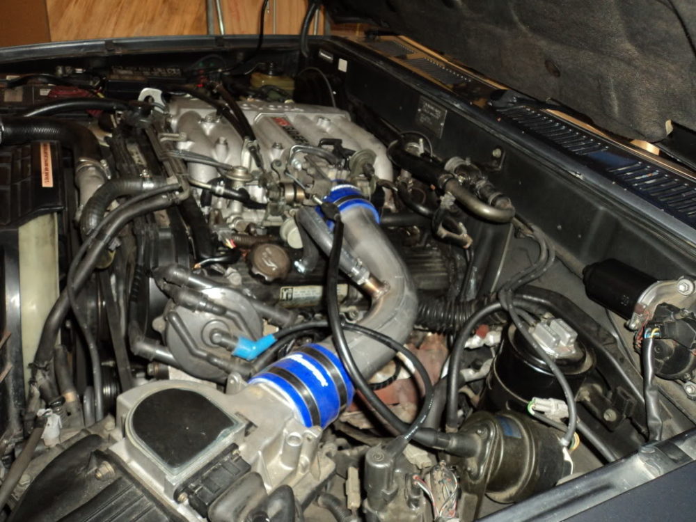

“Do you like doing mods to your truck that serve no useful purpose???” asks millball.
“The mod really doesn’t help performance at all,” adds Mclaws89.“Decreases the longevity of the intake and makes stuff louder. If you do the project, hold onto the original stuff. If you are anything like me you will want to throw it back in in ten years. When you are sick of looking at the aftermarket one in there. But projects like this are fun and everyone should try stuff on their truck.”
Even so, there’s at least one benefit to doing so, according to maninnepa.
“Getting rid of those two boxes and hoses makes it a LOT easier to check your tranny fluid if you have an automatic!”

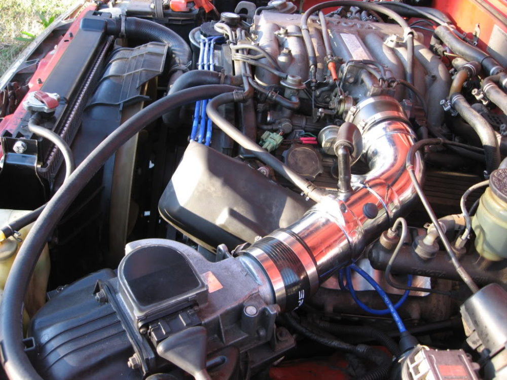

“It’s an easy mod to do. The boxes are there for nothing more than to silence intake noise. I replaced mine with a single pipe and a cone filter. I did it strictly to free up space in the engine bay. The intake is only a tad louder but not annoying. It actually has a pretty good note I think.
As for the hoses, they are important and can’t just have a mini filter installed. They all will essentially introduce a vacuum leak and cause a lean condition if they aren’t plumbed into the intake piping after the AFM. The one on the valve cover is the PCV vent and is absolutely required. The small one out front is for the A/C and power steering idle up control. If you have neither of these functioning, feel free to cap them off or leave them disconnected. The large one is for the PAIR valve. Again, if it’s non-functional or deleted you can cap it off.
EDIT: The pair valve doesn’t actually need to be plumbed after the AFM. If done so it’ll actually cause a rich condition. It only needs to be filtered, so plumb it in between the AFM and the filter, or give it its own filter.
Also it’s the noisiest among them. That’s why it got its own silencer from the factory. If you only filter it, you will definitely hear some extra noise, mainly at idle. Ultimately I’d recommend just deleting it along with the EGR as long as you’re not tied down by the EPA. It was worthwhile for me. It makes for fewer components to fail and makes changing spark plugs about a 5 minute task.”
