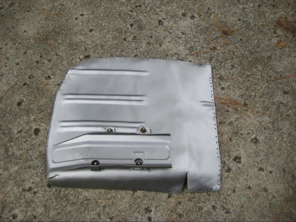

Things ran into a snag, however, when the OP couldn’t find a set of floor pans to fit his Toyota. So he did what any good fabricator would do – he bought a set for a Ford Bronco and modified them to fit!
“I used posterboard to make a rough pattern for the new pan. After a lot of cutting and tweaking here’s the driver’s side pan. Note the exhaust heat shield, attached with 4 bolts that weld to the bottom of the pan underneath the gas pedal.”

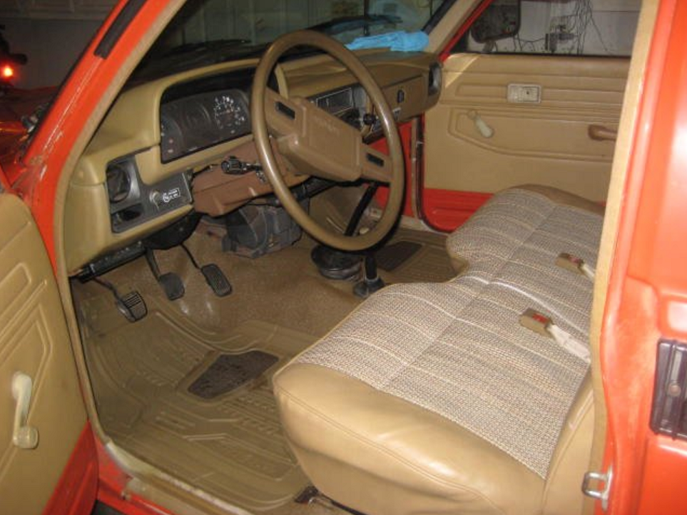

The next step was to get a new vinyl floor mat to replace the tatty old one. With that and a freshly recovered seat, the interior of this old Toyota looked just like new again.
1980 Toyota Pickup
