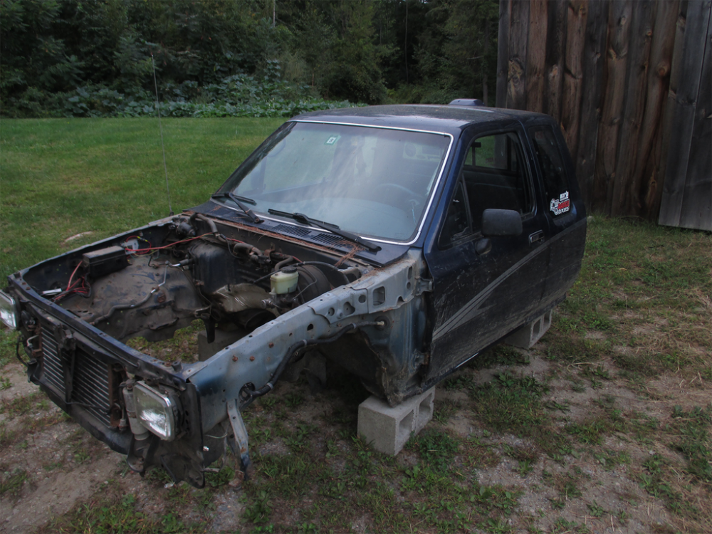

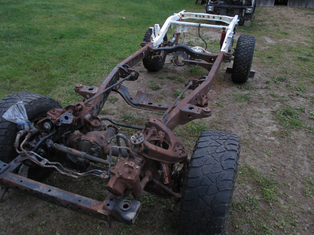

“The Begining! Spent a couple hours here and there breakin ‘er down to the base elements just cuz that’s how I start on things.”
1994 Toyota Pickup

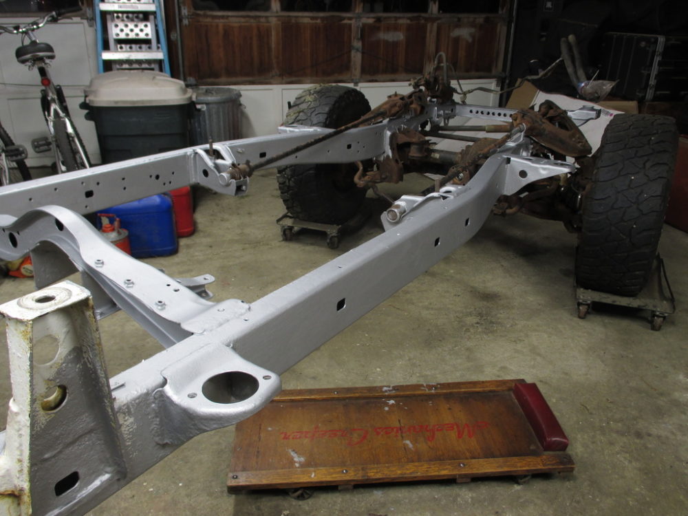

First, he spent a good six hours sandblasting the frame. Then it was time to future proof the base, which is always a good idea.
“Two coats of Mastercoat. Next up: white tractor enamel. I like white because it makes rust spots easy to see so I can fix them before they get out of control. I’m not going to bother painting the IFS because it’ll get cut off next year and it’s really not in good enough shape to make it worth painting anyway.”

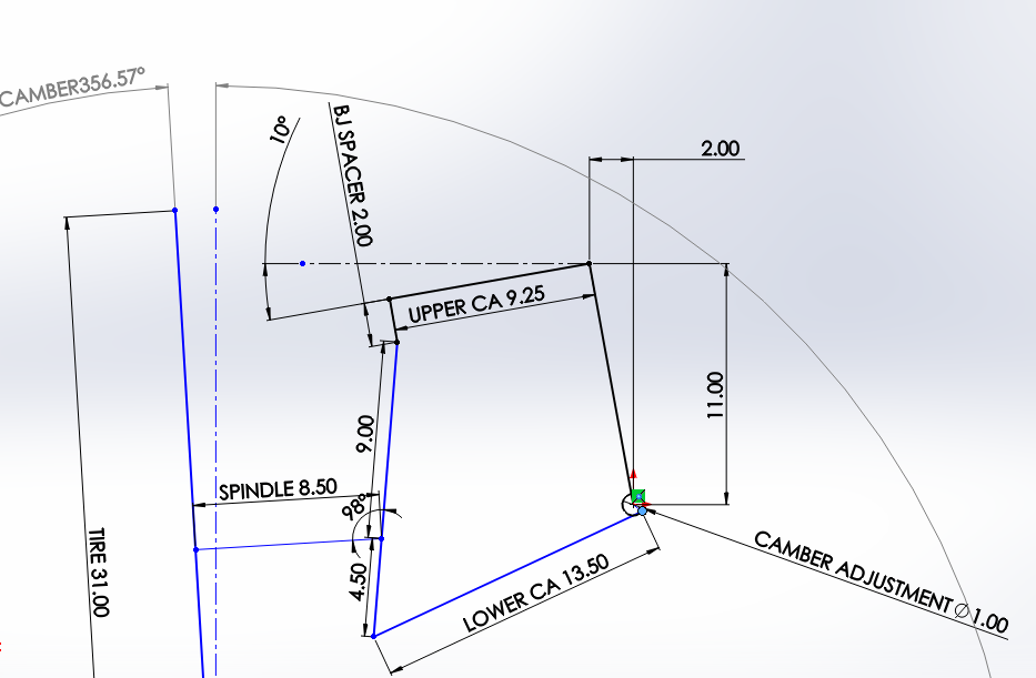

“I’m going to start working on BJ spacers for the upper control arm. I’ve seen the spacers people commonly use and since I’m machining my own anyway I thought I’d see if there is any better way to design them.”
So began a little research and a ton of math.
“I looked around on the internet and here a little bit but couldn’t find the exact factory control arm geometry. So I just took some rough measurements which should be enough to help me figure out if making fancy BJ spacers is worth the effort.”

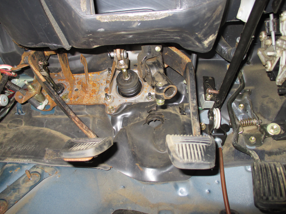

Once he got that all sorted, it was time to get back to actual metal fab. To make the switch to a manual transmission, the OP used a rusted out donor truck.
“After the holes for the master cylinder were drilled, the manual pedal assembly and master cylinder from my donor rig bolted right in. My cab even had the extra threaded hole for the bolt above the clutch pedal!”

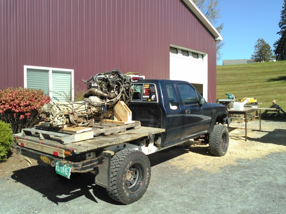

And before long, it was time to install the engine as well.
“The 22R mount is an inch or two forward from the 3VZ, so I torched off the 22R mounts, cleaned them up, cut them off, and cleaned the 3VZ frame. Then I bolted the 22R mounts on the motor and set it on the frame with the 22R crossmember so I could mark the mount location and weld them on.”
