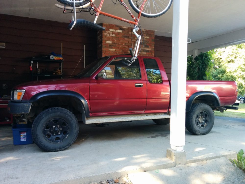

“Hey all, this 3.0 came onto my radar recently. And, well I kind of just bought it out of nowhere. I’ve been looking for the right compact truck for a project, and this one fit the criteria. The seller was motivated enough to come down significantly from his asking price, and now here she sits.”
1992 Toyota Pickup
And that’s when the fun began – initial cleanup and discovery! Which, as we all know, can be good or bad.
“The odometer reads 457,XXX. PO had it for only a few months and knew nothing about the work done or the PPO. So unfortunately, I knew very little about this truck before taking the dive. Luckily, after now spending a couple days cleaning, changing fluids, and removing broken crap, most of the surprises have been good ones. Frame is solid. Cab/int is immaculate. Had an hour long drive home with it on the highway, and I was blown away by how smooth everything felt, at almost half a million kms.”
