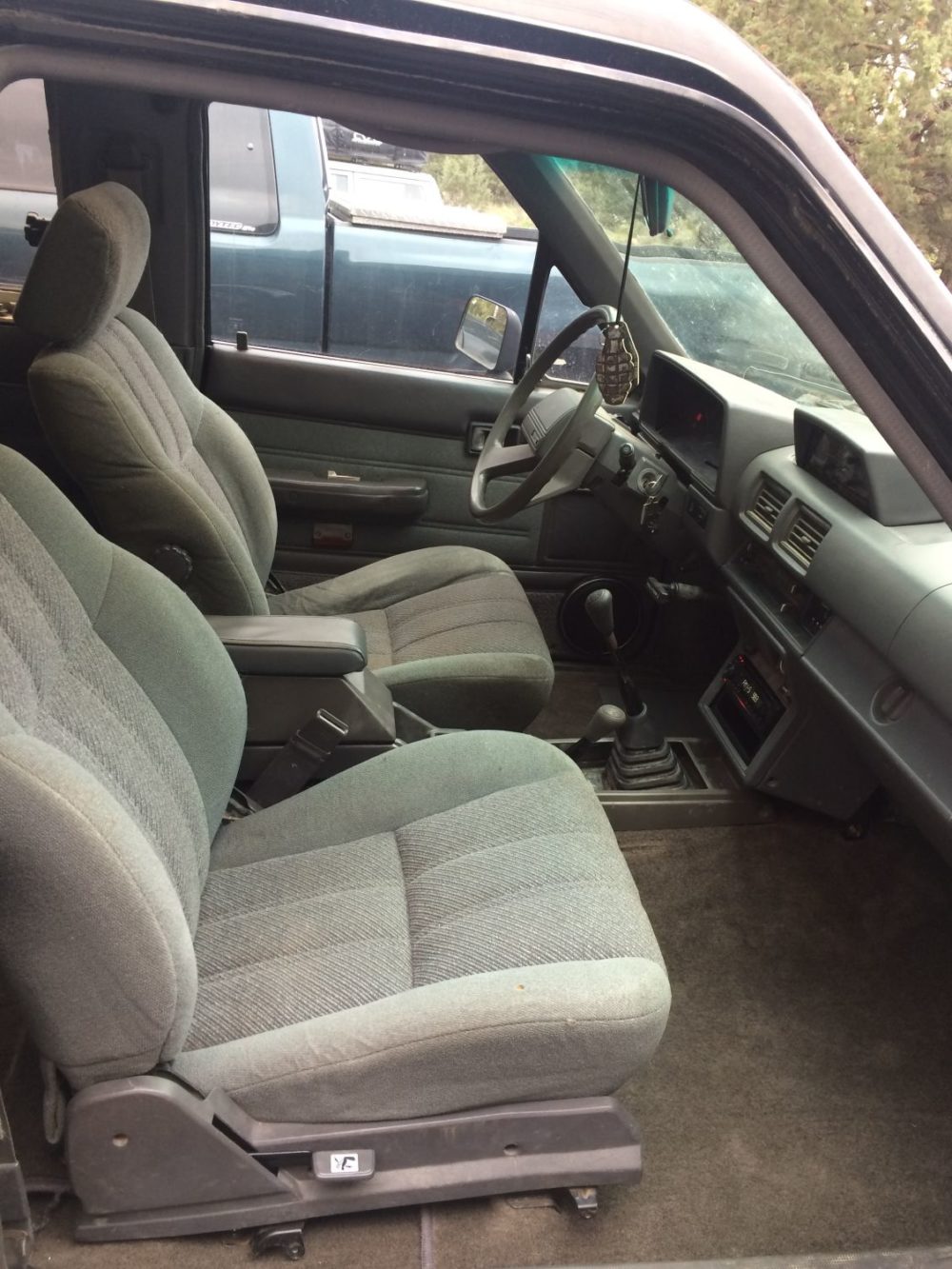

Soon after, the interior was nearly complete and looking dramatically better than before. Toyota 4Runner
