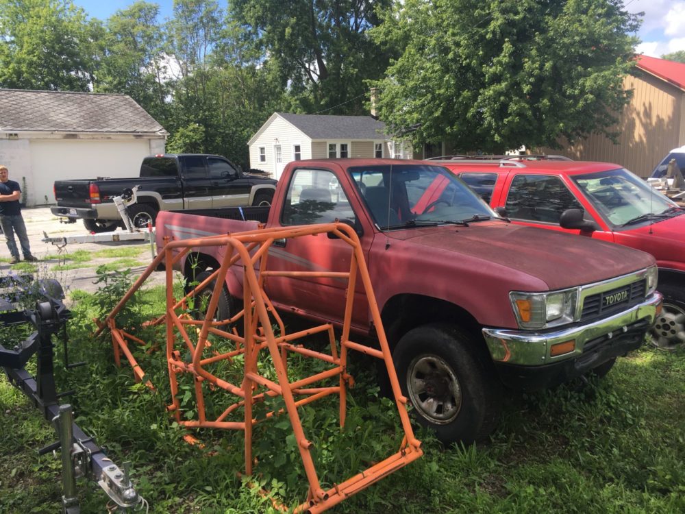

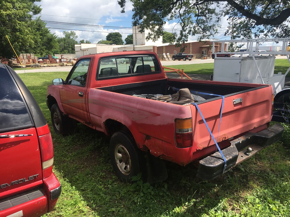

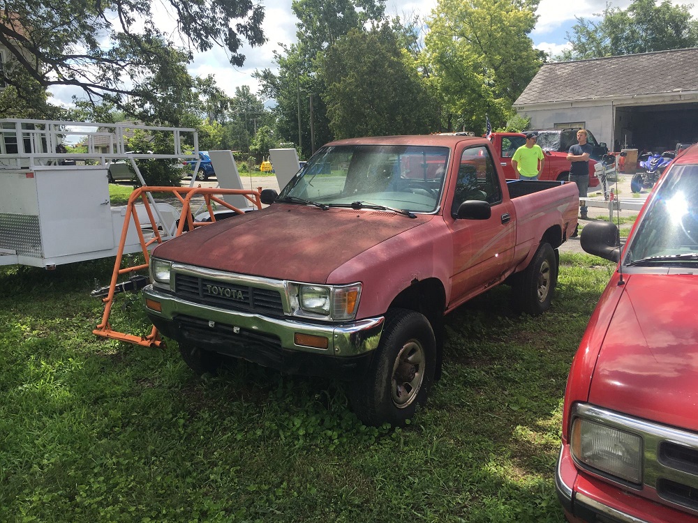

“Flash forward to a normal sunny Saturday, my father and I were taking a load of scrap to the scrap yard. On the way driving back home he noticed an old pickup back by the weeds. So, I pulled in and asked the gentlemen if he wanted to sell. The answer was a surprising yes and I learned it has a decent rod knock to it. Not to be discouraged, I asked him the price, still expecting a $1-2k dollar answer, as they are worth a lot in my area. The number he came back with was so surprising I agreed to it on the spot.

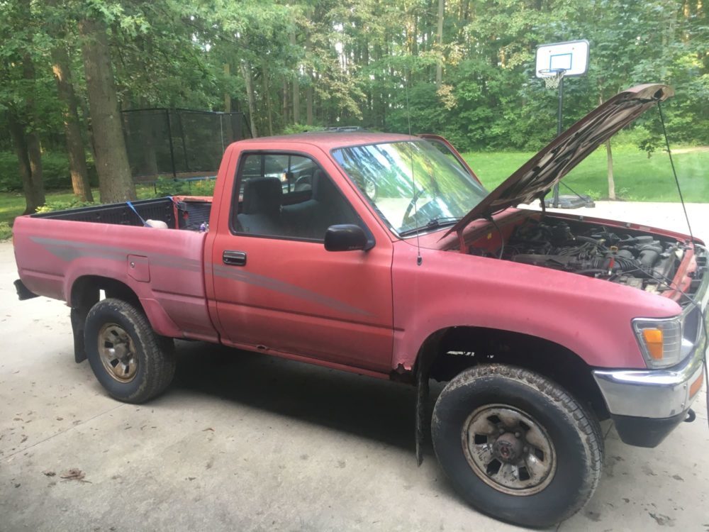

“The truck is a 1991 Toyota pickup base 4×4. It has a 22re and 5-speed manual transmission. It is a single cab shortbed with an immaculate interior. The motor has a brand new head and head gasket. The clutch is good and new headlights, sending unit and exhaust system”

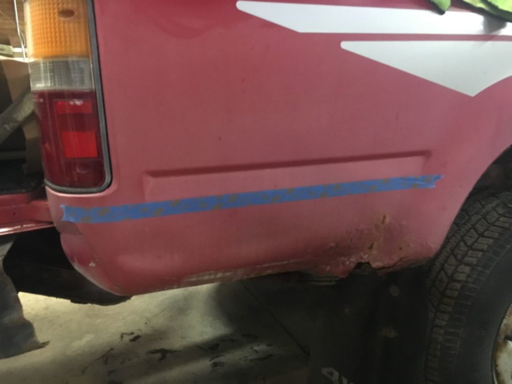

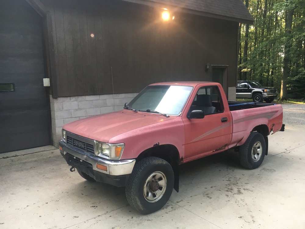

Of course, once you start digging into these kinds of finds, problems begin to mount. And our friend’s enthusiasm quickly diminished once he got the old truck home.
“Well I got her home. Motor is definitely shot, needs a battery,  front left wheel bearing is trashed. And the brakes need work. The radio also doesn’t work but other than that definitely cool little truck.”

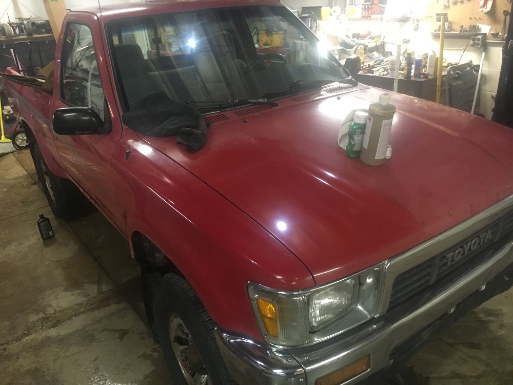

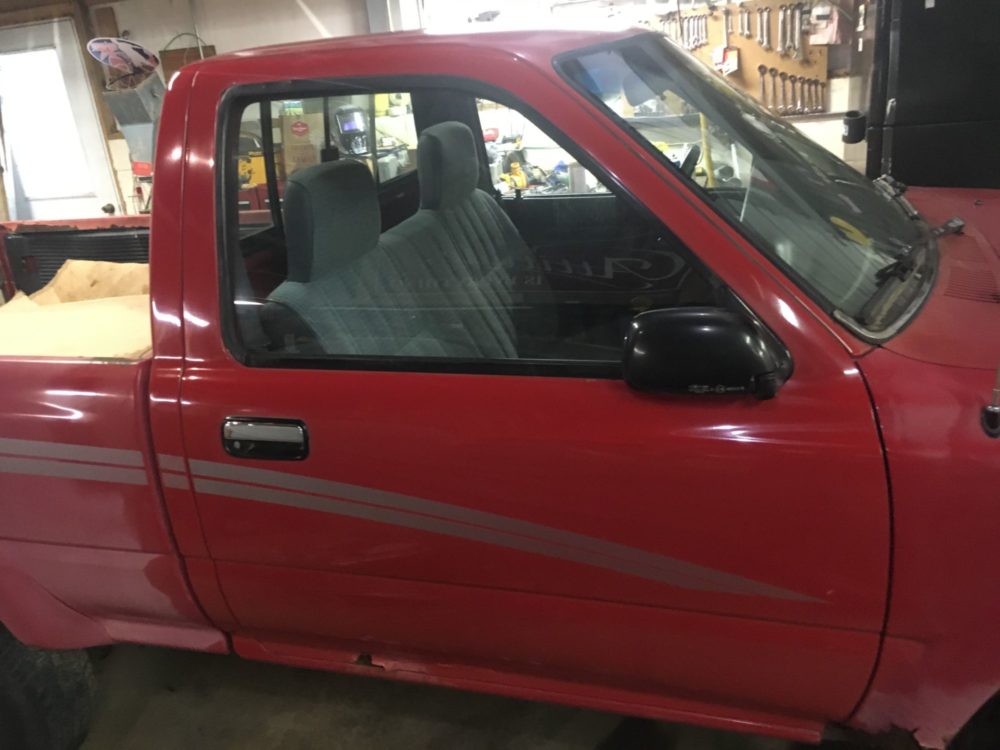

The salvageable panels certainly polished up nicely, thanks to a little elbow grease.
“I’m using a three step process right now. I used a course polish bonnet with Turtle Wax compound about two passes. Then I use a fine bonnet with Meguiars ultimate polish. And then a hand wax with Meguiars cleaner wax.”

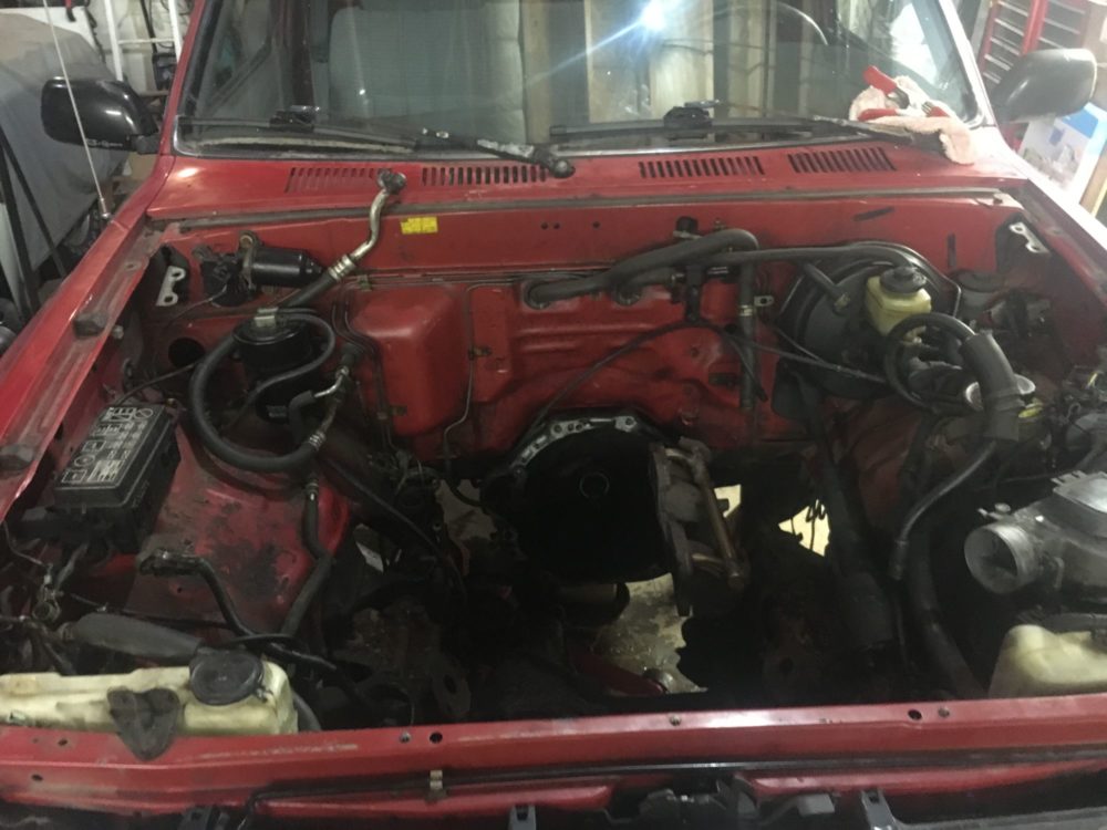

Next, out came the old motor. But before the donor motor goes in, it’s going to receive a little bit of a refresh, along with some other new components.
“I’m going to get a new timing chain with steel guides, a new clutch kit w/throwout, pilot and pressure plate and a new slave and master cylinder. That way I know I’m good. I will also need some gaskets for the head and exhaust. For all the transmission stuff it will be about $135 and the timing chain and guide is $30.”
