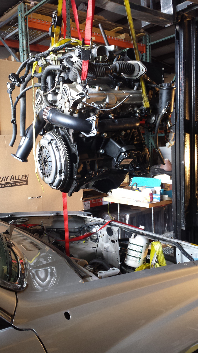

a very pretty motor. clean as hell. i do believe what i'm told that it has 57,000. cut out from the frame - frame chunks still attached to the mounts motor when i bought it. intake manifold was cracked i think when they pulled it. i don't think you're supposed to pull this motor with the manifold attached to the driver's side brace/hook.
going down, down, down...
...and bolted in. an eight hour day.
