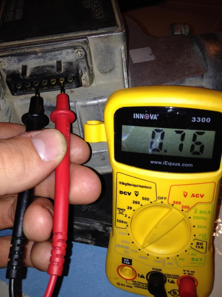

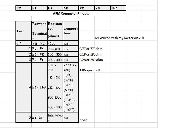

Tonight I took the AFM off and took it inside to check it out. Here are my results in a table.
As you can see everything is good except the e2-vs test which if I have everything set up correctly is WAY off. could someone please check my work?
Hopefully I just finished the puzzle, if not I will keep adding to this thread on things I have done.

by the way that test was all done per 4crawlers static test. Im going to do the dynamic test most likely sometime in the morning.
