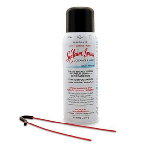

I like to do things the easy way. And removing the plenum, knocking out the freeze plugs, several cans of carb cleaner, using a drill or some other extension tool to clean 20 years of crud out of the plenum seemed like an awful project.
So instead, I first decided to use the Seafoam Spray. It didn't do much to clean anything out of the upper plenum. However, the application straw is critical for the next step. The straw looks like this:
Quick, Easy, Painless 3vze Intake Plenum and Upper Engine Cleaning and TuneUp-qpd6dc2.png
And you use it by locating it at 12 o'clock and running the engine at ~2500 RPM to ensure your throttle plate is open wide enough to allow the spray past and not damage your TPS -- to adjust the straw length, you need to open and close your throttle plate, and I think only about 1/2" of the straw extended past the the black pinch protector for me. Like this:
Like I said seafoam didn't do much for the way of cleaning. It did make a fair bit of smoke, but I think that's the seafoam mostly, just burning itself off. Perhaps some cleaning within the engine cylinders but little to no cleaning of the upper plenum... (On the 3vze, fwiw you have to do the spray not the vacuum hose w/ standard seafoam method due to the nature of the intake design -- all of the vacuum hoses hit only the rear 3 intakes, so your front 3 will stay dirty.)
So seafoam was mostly a bust.
