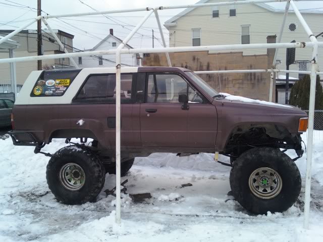

FWIW Heres my junk with a TG 4" SAS on 36" Iroks
I'm now running RUF (about 2" lower than TG "four inch" springs) and can RUN 39.5s with the pinch weld and firewall beat

wow that runner sits really high. i like it
