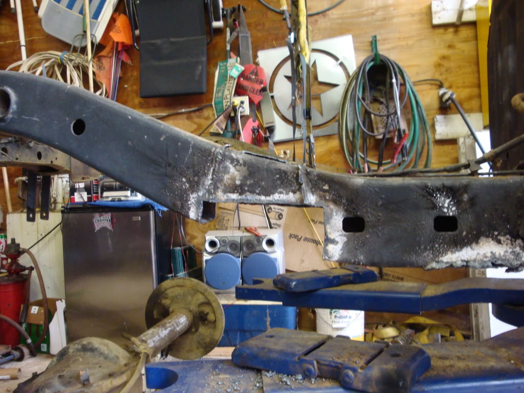

found these on Pirate:
Frame cut for hangers

What are you doing for the front? Unless you are going reverse eye springs or SUA, French them in the rear is worthless.
