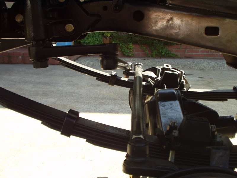

I even cut mine to move the box forward even more and rotate it to use a flat pitman arm...
hope thats helps!!
