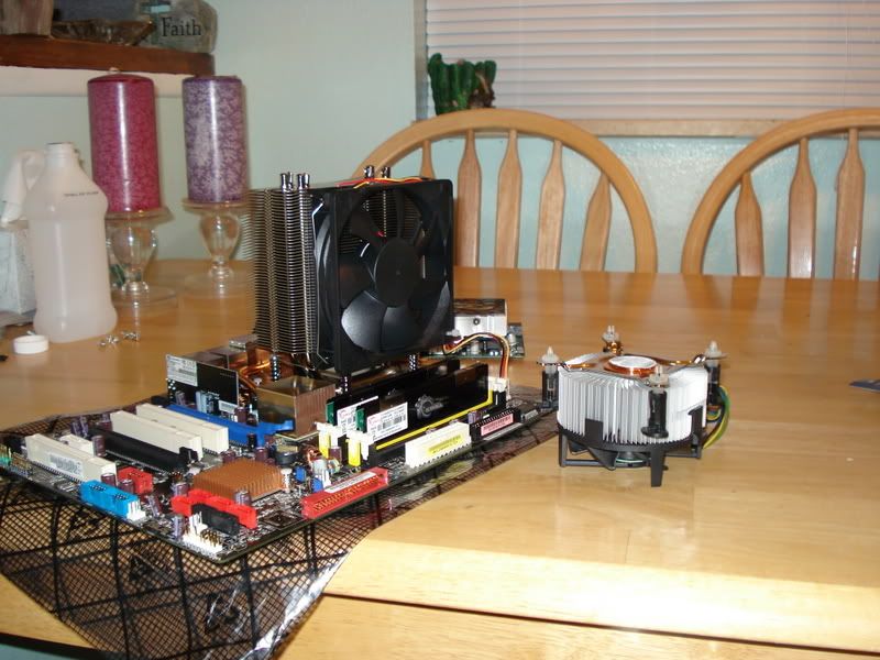

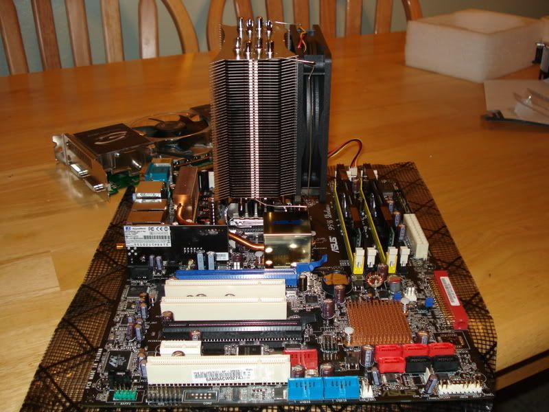

Also, If your going to overclock, I highly recommend a Thermalright Ultra-120 Extreme CPU cooler.
http://www.newegg.com/Product/Produc...82E16835109140
Heres mine...
Next to the wimpy supplied cooler...
Heres mine...
holy christ....
Old Dec 15, 2007 | 05:00 AM
onesojourner's Avatar
Joined: Aug 2007
Posts: 158
From: Springfield, mo
that is the biggest heatsink I have ever seen. It looks awesome though.
