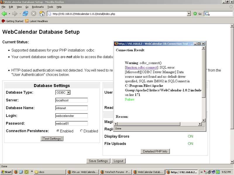

Ok, so i am doing this in windows xp not linux as instructions seem to think but none of the commands seem to work, i just get a syntax error.
Now i was able to use different commands to get some of the stuff done, like to create the database i used.. "create database intranet"
And i think the mysql intranet < tables-mysql.sql command worked, because if i enter it again i get all these errors about how it is already created.
So when i try to go ahead with the instructions and configure the software to match the database it can't find the database...
If anybody knows what i am really doing (or not doing) in SQL (or should be doing) please let me know i am so lost

I am really tired right know, and even though I am usually able to help with these errors (mainly because I have been through a lot), I have a total brain fart.
But here is my pathetic try... is the "Database Type" supposed to be "OBDC" and not mySQL? What are the other choices?

From the error, it looks like the webserver doesn't have the ODBC driver for that database installed.
Is this webcalendar thing a app you downloaded then tried to install? The screenshot is not an interface I'm used to.

yea, is this supposed to be webbased or on your computer? i bet youre just missing a driver.

Yeah, database type is definitely not odbc. You need to use the native MySQL database connectivity if it is offered. YOu don't want to use odbc, period.
Apache and mysql have nothing to do with each other unless you're using mod_auth_mysql. PHP is what is actually making the connection to the mysql server. know I"m a little late on this, but I thought I'd throw this in. This is what I do on a daily basis. (PHP/MySQL development)
