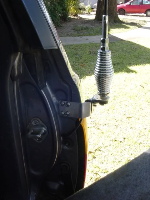

PS the mount I will be using is made for that kind of thing. The difference in placement is shown here:
on SC4Runner's rig versus:
on Poul D'eau's rig

This is a picture of a XForce CB antenna mount. This is for sale through XForce amps. This is also for sale through Davemade amps.
