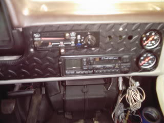

Mark, you asked how I replaced my dash.......
I have changed the radio since this picture.... I really wanted to keep the old school radio, but it started smoking inside shortly after I put the ruck together.
Dood, that's a sweet looking dash and radio. Good job man.
