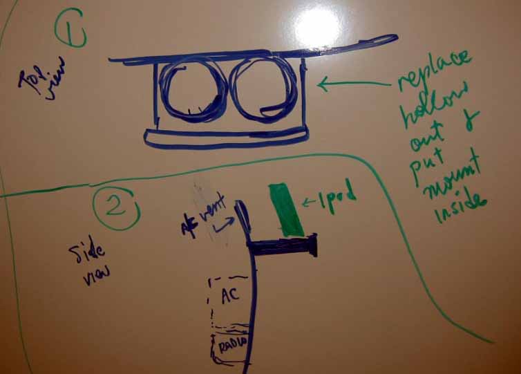

you know, a few weeks ago i was about a click away from buying an ipod mini and the same question came to my mind as well. since you have a crappy, slideout cupholder like mine, i considered building a stabilized ipod mount right on the slideout cupholder. because of some of my prior custom work (cupholder mod, switches, etc) i have all the tools and knowledge to do this. it would involve a lot of custom work, finding the right materials, fiberglassing, bondo-ing, sanding, plastic building, etc. bottom line: if you have the right tools and knowledge, it can be done and look totally stock!
doing it this way would allow you to easily (and safely) change your music without looking dangerously down and behind you like you are proposing.

ok, check out the attached pic
1) is the top view. basically, i would figure out a way to use the frame of the cupholder and make a solid tray. that tray would hold the ipod cradle thing and then i'd fill in the remaining void with some solid material and then plastic adhesive/putty (sandable). of course, the cord would run through the back and down into the back of your head unit
2) this is the side view. the ipod would be tilted back and slightly tilted towards the driver. who cares about the passenger . one of the things i'd recommend though is to figure out a way to LOCK THAT DAMN SLIDING CUPHOLDER! that thing vibrates like crazy and a locking mechanism to keep it solid would do your eyes wonders when driving
thats my thoughts. if i had an ipod and a lot of time to do this, id do a writeup for you. but that's my thoughts on the subject.
bob
