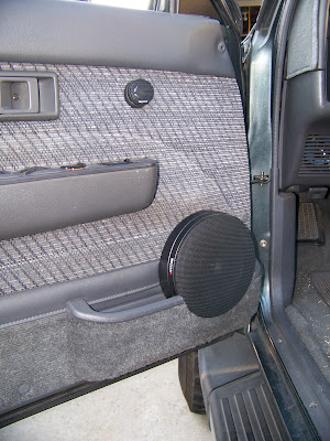

You can also use speaker pods for 6.5" ones like I had in my old rig, the '91 4Runner.
http://www.pnw4runners.com/tando/pods.htm

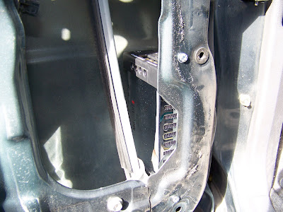

you have to either remove the door pocket or modify it for the speaker to fit as this is the only place in the door you can install a 6.5" speaker. I also chose to install the crossovers inside the door to keep them out of the way
