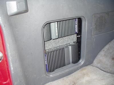

Don't bin the stock system. unless you are intending to spend loads of cash you can get a good sound from the existing speakers
Here is the info on my system built using the standard Toyota speakers and adding a little bit to it
(this was posted on the UK Forum)
If you want bass get a Sub - it needs to be a minimum of 8". for best results go to either 10" or 12" this depends on what you actually listen to. if you listen to classical 8" is fine on the other hand if you listen to R'n'B, Drum & Bass, Thrash Metal you'll really need something that can handle low sub-bass frequencies.
If you still have the OE speakers and they are working fine DO NOT bin them and certainly don't throw the little black boxes they fit into.
The stock Toyota ones are (front) 4" paper cone all range speakers @ 4 Ohms fitted into a purposely designed box which is ported.
(rear) 5 1/4" all range speakers @ 2 Ohms fitted into a purposely designed box which is ported & 2 x 3" Tweeters fitted into the rear headlining infront of the rear window.
I, like you, want decent sound in my truck and having built 2 sound-off cars, and fitted rucks of gear into my Artic, was not satisfied with the system that was already in place. I have looked at door builds, dash builds, boot builds and as Andy has said, sound deadening is a route to be followed.
In the end I opted to go with the OE gear, Why I hear you cry,
Basically because I couldn't face ripping the doors, dash,boot to bits just to fit stereo gear so I took a gamble and did it like this: -
Sony Head Unit with RCA Front & Rear connections to an Alpine 4 channel amp. This amp powers the OE speakers including the tweeters in the roof.
Dedicated Subwoofer RCA to an Alpine 2 channel amp. This amp is bridged into Mono mode and powers a 10" Jensen sub (my mate owns an ICE shop and I got it cheap!!)
I have up graded all the cabling including the power feeds,fuses etc
This system is LOUD, CLEAR and perfectly fine for all types of music.
I took it back to the ICE shop and they had a listen and the comments were "for a stock set of Amp'd up OE speakers - it's bl**dy good"
I'm a stereo n00b, so I'll need some input.
I'm under the impression the measurements are as follows:
Front dash = 4"T (but 4" will fit)
Yep 4" in a purpose built box
Rear cargo floor = 5-1/4" (also heard 4")
Yep these are run at 2 Ohms
Rear cargo roof tweeters = 1" (?)
No- these 3"
What size amp would I ideally want to power these? I would assume a small one would do. How many watts would do the trick?
These size of the amp is relative to the number and wattage of speakers you want to power.
EG - if you buy an amp which is rated at 4 x 50 watts RMS and you want to power 4 x 100 watt rms speakers the amp has to work twice as hard to achive max power. This is not good for the amp!! it will eventually give up (overheat) The way to do it is to buy an amp which is rated 4 x 100 rms and run 4 x 50 watt rms speakers. this way the amp will never run at full load and will happy play all day.
Remember all the amp does is reproduce the sound sent by the head unit.
Brands aren't an issue, all the big names (sony, pioneer, kenwood, rockford fosgate, kicker) all sound the same to me.
If that is the case it all comes down to price and your own preference of colour, size etc
I need verification of the sizes from someone who has ripped their 2nd gen apart before. I don't want to cut holes, or modify anything, I just want it to look stock.
I have added a pic of my amps - I didn't want them under seats as small children have a tendancy to kick or ram things up against them so I took one of the cubby holes in the rear apart and fitted them in there
I hope all the above helps.
