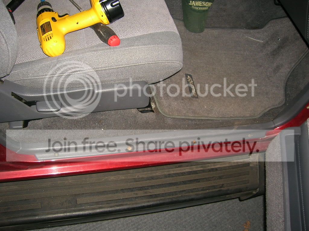

Next, remove the sill plates. Front door has 4 screws (philips head) and rear has 2 screws. Loosen the screws and Pry these up CAREFULLY!!!
(note- this is passenger side, front)
Now, begin to pull the carpet back.
Carefully pop the plastic clips from along the rails as marked.

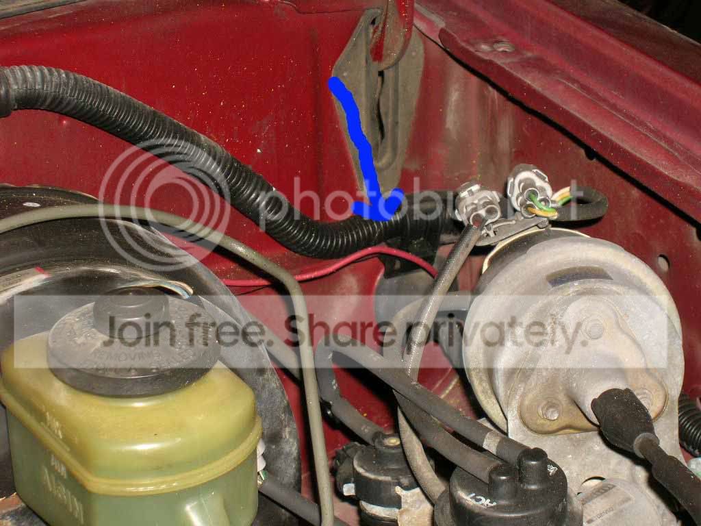

1. disconnect the positive terminal from battery. Attach the pre-terminated end to the factory battery ring. Route the cable along the firewall, above the hood-release cable to the driver's side. Zip tie it to the hood release cable to tie it back. Not too tight!
Now, most folks will just punch a hole below the master cylinder with a Uni-Bit to run this cable. I don't like to do this for several reasons- it leaves a rough edge that could tear the jacket of the cable, and puts another hole where water could potentially leak through. I look for existing grommets from the factory.

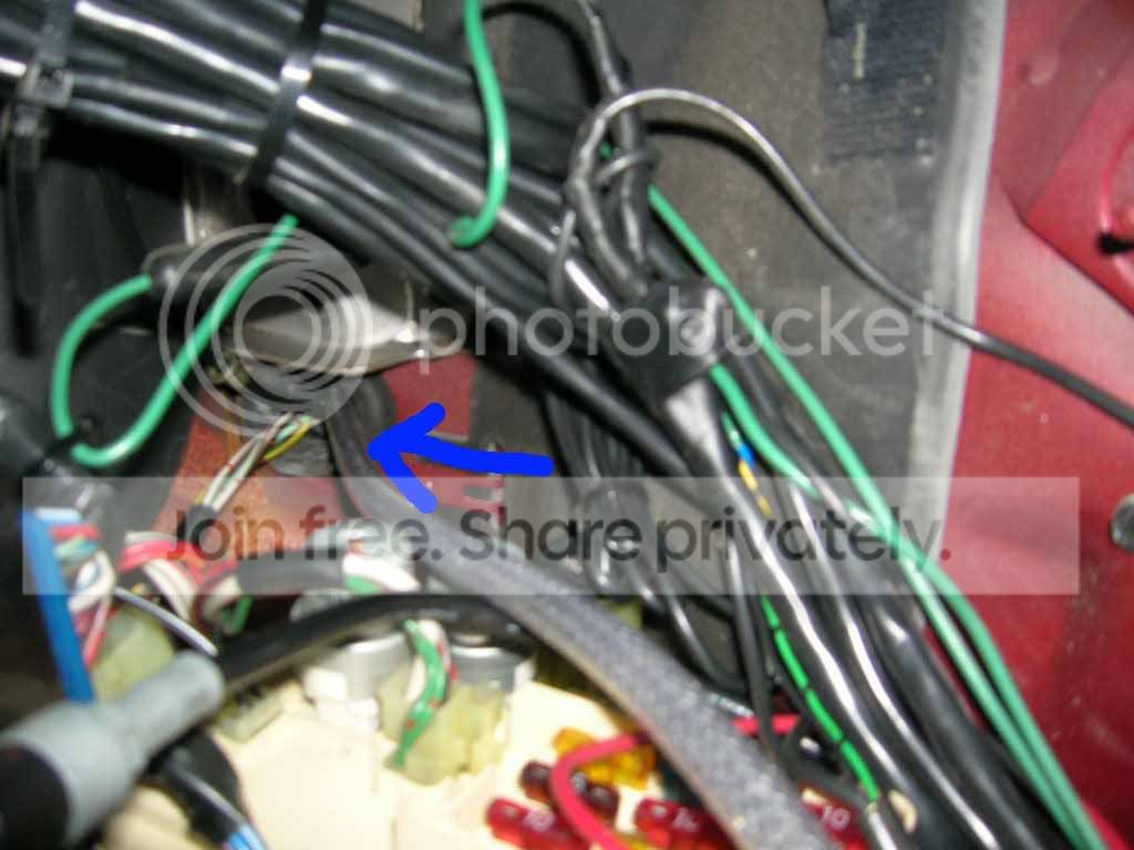

2. In the back corner of the firewall, you will see a rubber grommet where the hood release cable snakes through. From the inside of the vehicle, carefully push the entire grommet through into the engine compartment. Using a pair of snips, carefully cut a hole in the grommet for the new power cable to fit through. A couple slits is all it takes, since it will stretch around the cable to seal.
Internal shot:
Note- the bundle of black cables is part of an old school cell phone i removed at the same time.
3. Pull the cable through and into the compartment. To re-seat the grommet, push back through from the engine compartment until it is back in place.

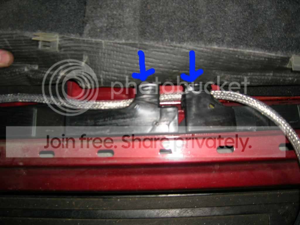

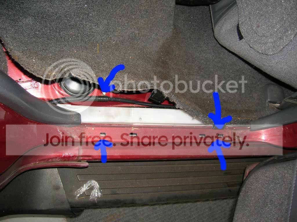

4. Route the cable along the door sill in the channels provided by the factory. Go under the exisiting harnesses, and stay within that channel as best as possible.

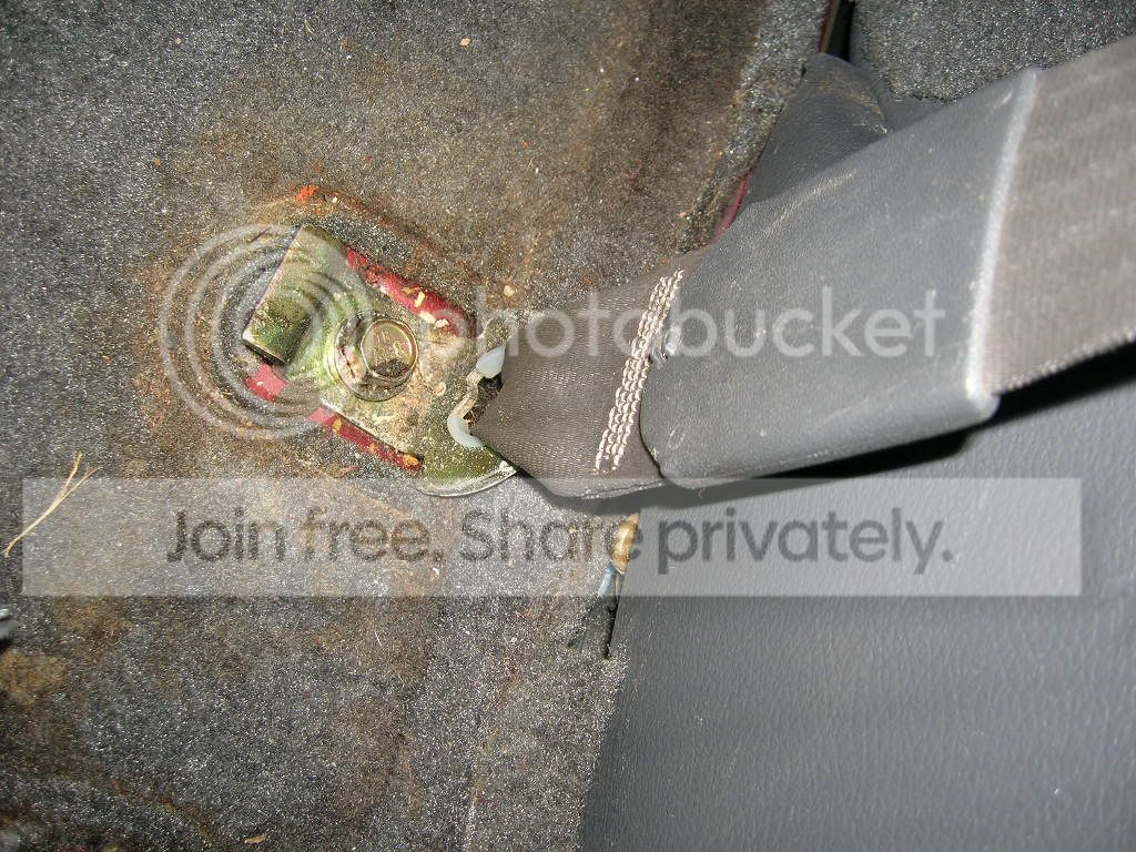

Its best to route the cable between the mount for the seatbelt and the trim panel...
(post install, cant tell there is a cable there.)
5. When the cable is to the back seat, pull the carpet under the seat up just enough to snake through, and go under the seat and into the cargo compartment. The 17 feet is enough to have about 1 foot of slack on the amp end for future connections. No need to route under that panel to the right. Run under the carpet and save yourself the trouble and potentially broken panel clips!
