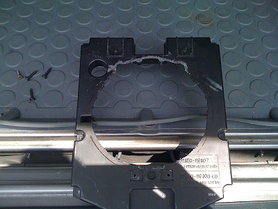

I did the rears tonight, 6.5". Removed the OEM "pods" angle grinder with a grind and sanding disk to make the surface flush and resized the hole. Then surface mounted the new speakers. Nothing too special but I took a ton of pics and I'll get them up for you guys tomorrow.
The most important thing when you're resizing the hole is to stay away from the factory port without moving towards the front of the car too much (the speaker surround gets close to the sheet metal (as someone noticed in another thread).
P.S. cheap speakers but holy CRAP the 4runner sounds great after getting rid of those 19yr old speakers.

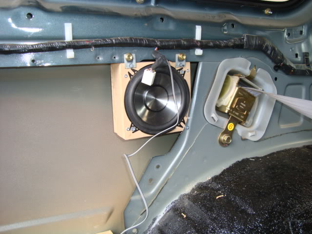

here are the pics you want ,i did mine today with 6.5 speakers ,keep and eye on the metal panel i fits but is to close to the speaker surround so take a plier and pull back a little the metal so it wont rub your speakers,you need to use some sealant like hot glue or silicone to make the speaker holes more air tight.you will be satisfied with the sound it will be more clear and the bass will be more clear too.

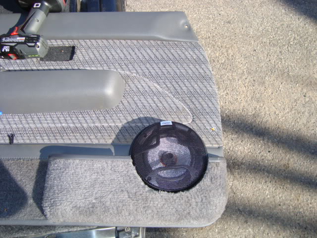

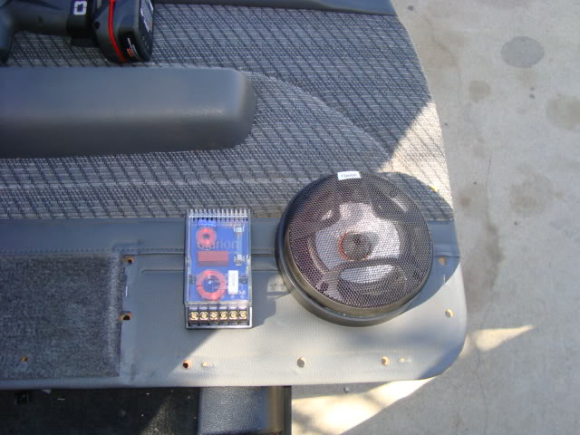

Here are some pics of my fronts that I installed
