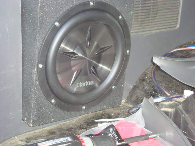

Here is my enclosure
Mine sticks out of the panel about an 1" because I wanted to build the enclosure to the required volume for the sub. The sub of choice is the Clarion SFW 1051 shallow mount
http://www.techronics.com/caraudio_9...Subwoofer.html
Just a suggestion, I'd scrap that particle board and use either 1/2" or 3/4" MDF. You will get much better results but I suggest 3/4" over 1/2. Otherwise you have the right idea and it looks good but make sure you give your sub the appropriate breathing room or it will prematurely blow.
