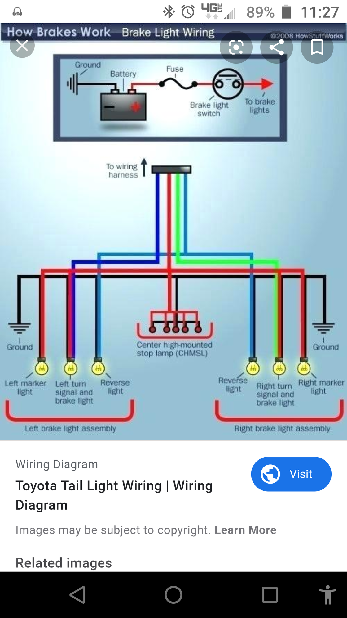

Gentleman with flatbed with cut rear harness. I was going through the same thing. I figured out that the white/black stripe=ground for left side. ( Don't ground lights on frame, won't work )! Switches supply grounds. Red/black stripe=reverse. Green green=taillights. Green/black stripe=stop lights. Green/yellow= left turn. Black/white wire=ground for all three. The others go to right side. It took me a while to get this figured out but it works now. Hooking up a trailer plug is a bit more of a challenge because you can't use frame as ground. Have to use the truck grounds. I hope that this helps you out if you haven't already figured it out yourself. Toyota uses a different wiring system than US vehicles.

Taillight harness diagram from online.
I'm trying to upload the diagram I found as to maybe help you out. It was a starting point for me.

Image of the rear harness diagram for the lights.
The diagram is just a starting point as I stated. Some of the colors are right.
