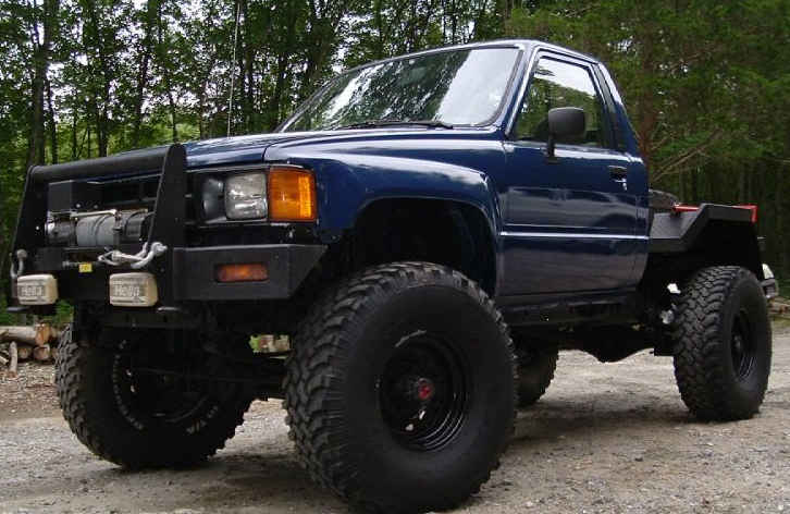

I'm just about done with my Rock rig... Minus Body armor of course.. I dropped a Buick 231 into it with a TH350 behind it... I am automatic racist.. I want a 4 or 5 speed for this truck, which sucks because I have two TH350's.. But I still want a manual... I also have two downey TH350 to Yota case adapters, Is there an equivalent manual out there for this combo>?? maybe the manual brother of a th350?? something that may work with the downey adapters that I already have??

sm 465 4 speeds are fairly cheap and rugged, nv4500 5 speed out of chevys are another option http://www.high-impact.net/transmiss...nsmissions.htm
