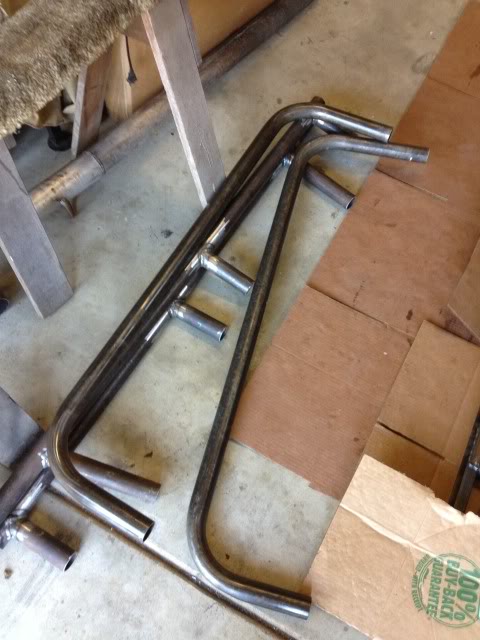

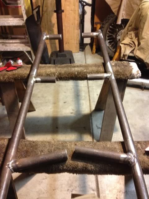

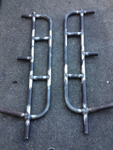

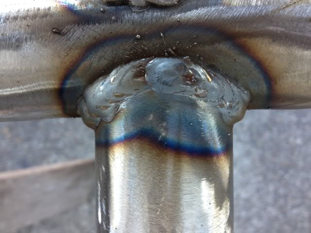

I built a set of rock sliders for my 87 regular cab the other day. I'm new to fabrication and am self taught when it comes to welding so any input is greatly appreciated.

Sweet! What are the specs of the tubing you used?

1 3/4 .120 wall dom

This was my first fabrication project. I think my biggest success is that I only had about 10" of scrap when I finished. I expected to throw away quite a bit more.

Nice job after there on the truck you could probably use your 10" of scrap to make a wide spot to use as a step If you wanted too Just weld 5 inches or so on the outside of each slider, slope the ends tho so you don't get hung up on them
\_______/ 《-- kinda like the this sorry best I can text draw

Fantastic looking welds. Looks awesome. Make sure and post pic when you get it powdercoated and installed

They look great. Nice welds also

What process did you use to weld them, looks like mig.

Yes, MIG. I use a miller 211 with .030 wire, 75/20 gas, on a 230 volt circuit.

Pretty good looking welds for your first fab project, very nice!

what are you using to notch your tubing?

Dewalt 4 1/2" grinder with a cut off wheel.
