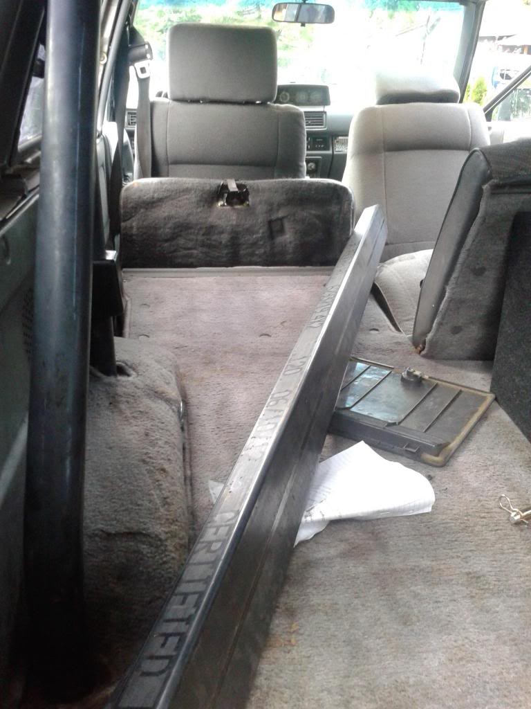

Went down to the local metal shop and got a whole bunch of 2"x4"x.120" rectangular tubing and a bit of 2"x1/8" steel stock to cap off the ends! Gonna get started tomorrow... Should look awesome when I'm done!

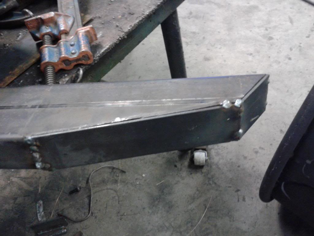

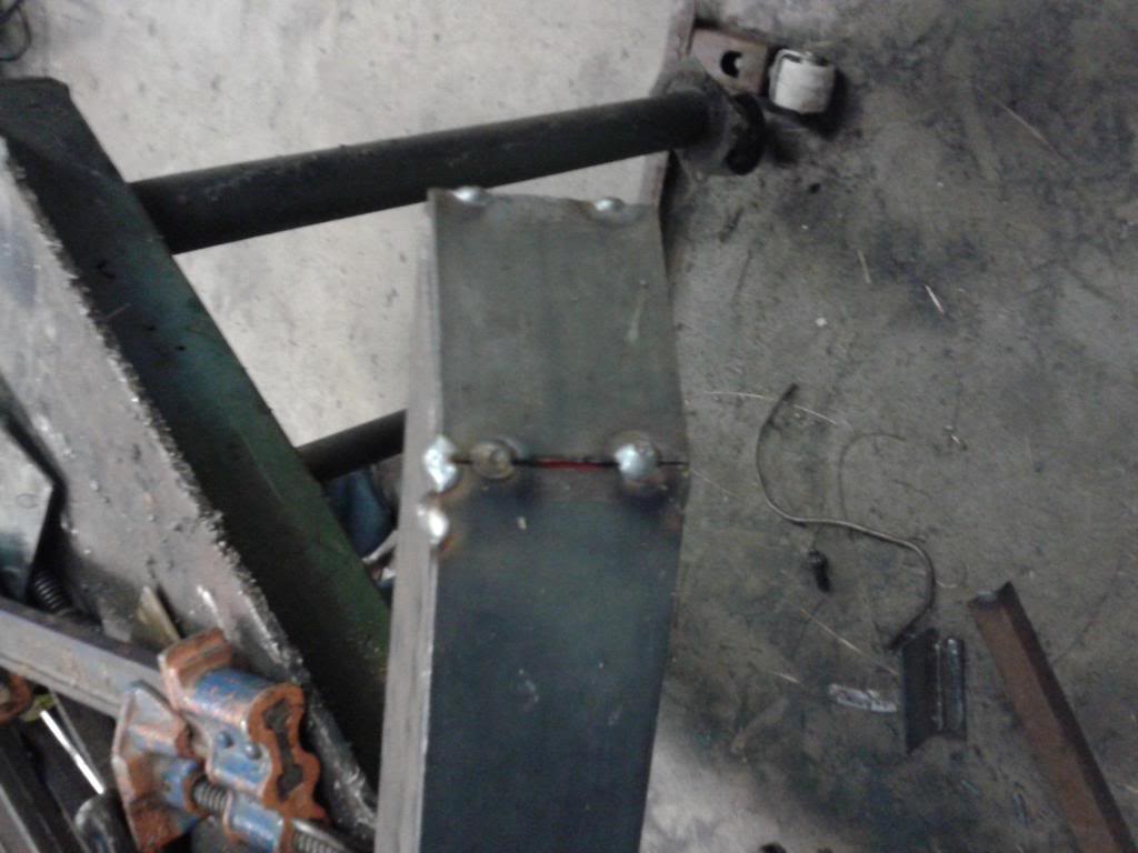

Made some progress today! Traced cut lines, made some rough cuts and started to grind 'em down until they look pretty!

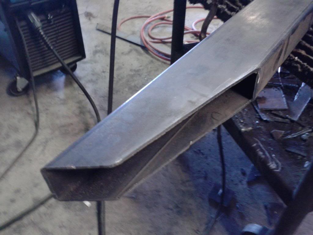

Major progress made today in class! Cuts cleaned up, caps cut, tacked, and now ready to finish weld!

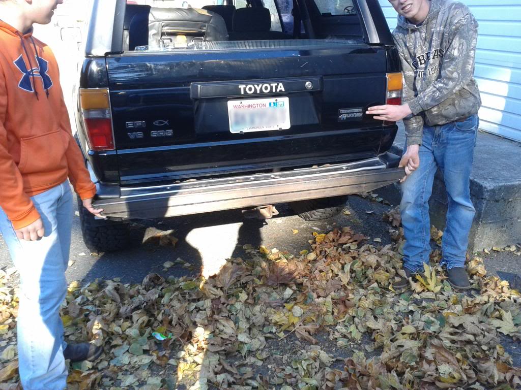

Small update!
Got some buddies to hold up the bumper so I could take a pic! It's gonna look sweet!

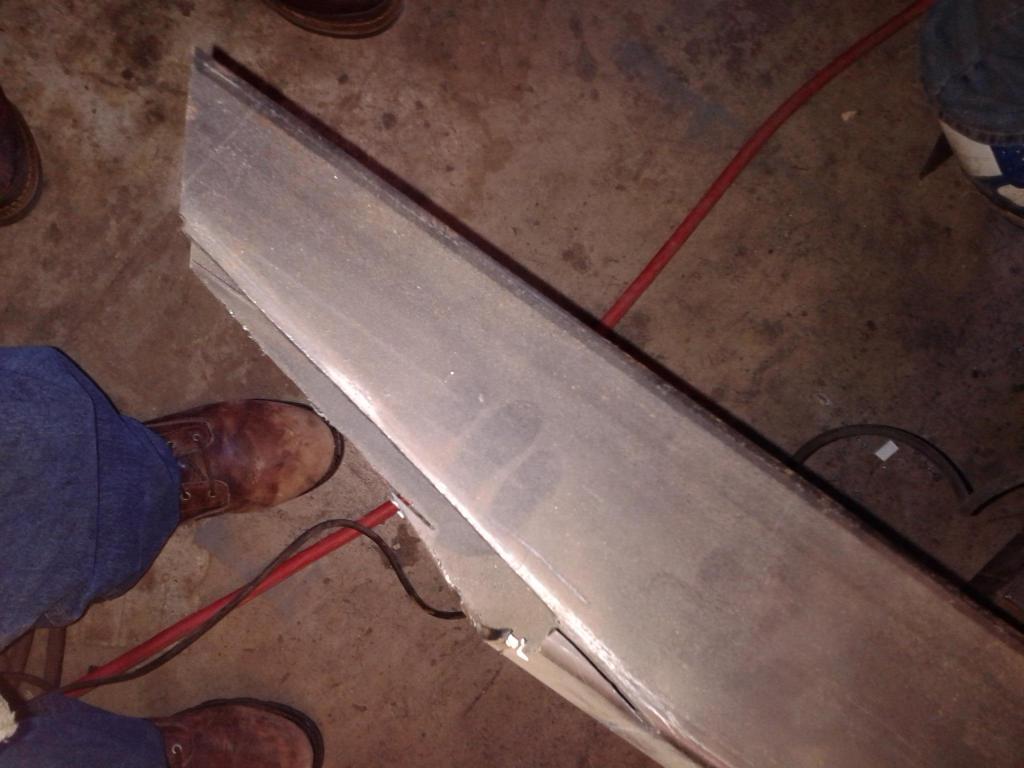

Also got the bumper ends finish welded, ground clean, and poly-fanned!
