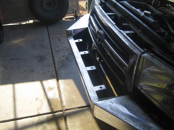

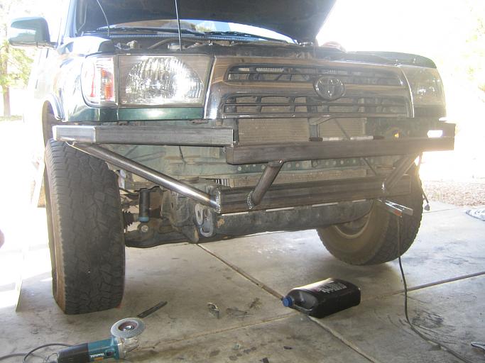

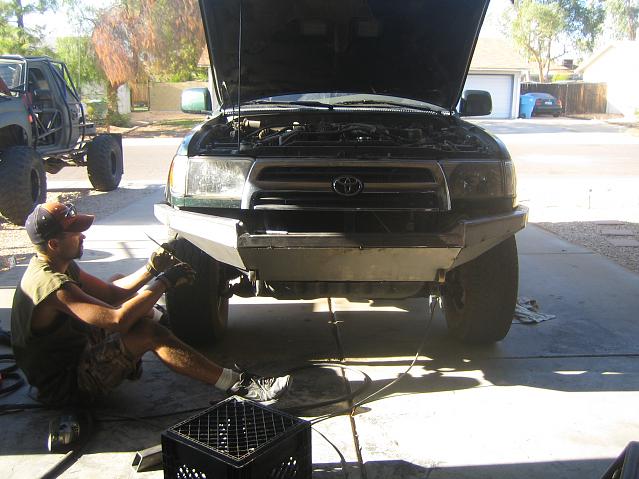

I have been staring at photos of Crolison's front bumper for many months and wanted to copy it. I ended up spinning it in a few different ways, but you can't deny the similarities. Here are some photos of it through out the build process. I am very happy with the way it turned out! Thanks again crolison for your endless supply of photos that helped my buddy and I out as we did this build.
Your back bumper is next on my agenda!
Attached Thumbnails New custom front bumper-front-bumper-build-day-1-017.jpg   New custom front bumper-front-bumper-build-day-2-008.jpg   New custom front bumper-front-bumper-build-day-3.jpg

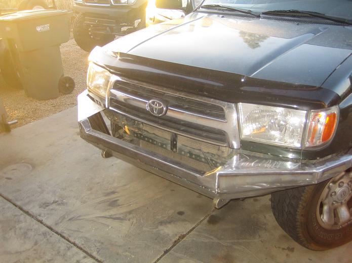

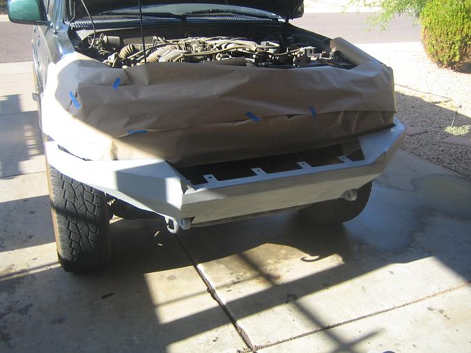

Attached Thumbnails New custom front bumper-front-bumper-build-day-5-005.jpg   New custom front bumper-front-bumper-build-day-5-006.jpg   New custom front bumper-front-bumper-build-day-5-010.jpg
