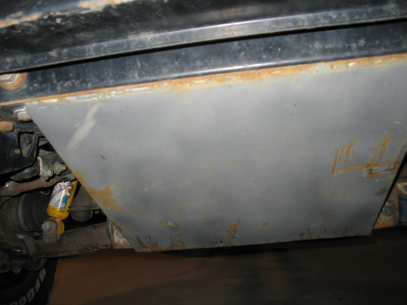

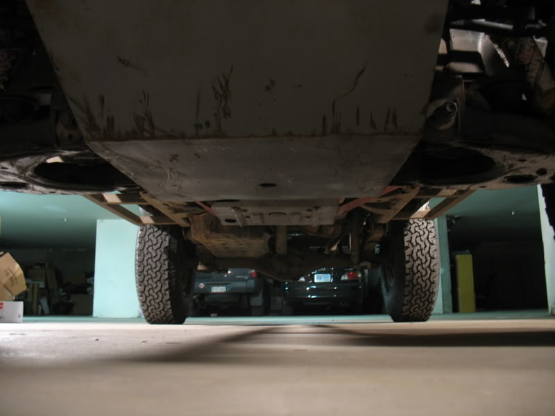

One, x eleventy billion on designing your own. Don't plagiarize.
I built my own.
3/16 plate, angle iron welded tent style. It's held quite well.

[QUOTE=AxleIke;51072812]One, x eleventy billion on designing your own. Don't plagiarize.
I built my own.
QUOTE]
i haven't gotten to look under it yet, i've been studying all week for a huge test i had friday, and i'll get to work on it this week and gusset my sliders.
but if i cna't find it monday... where do you bolt the skid into the ifs system underneath and at the back? i know where to up at the front
Thanks to the info from yall i think i'll go with 3/16 seeing as how there may not be much of a difference. thanks guys.
