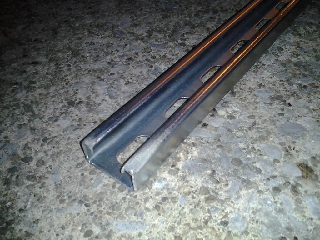

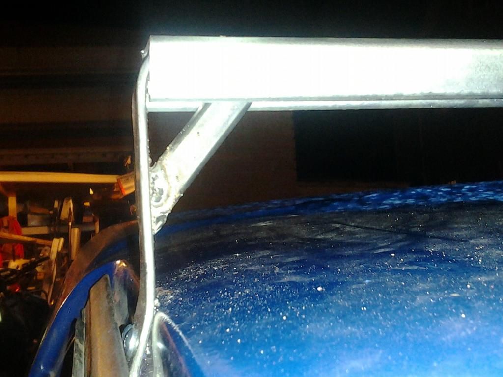

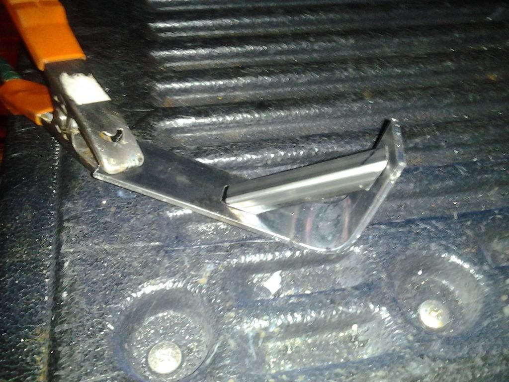

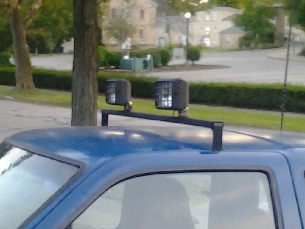

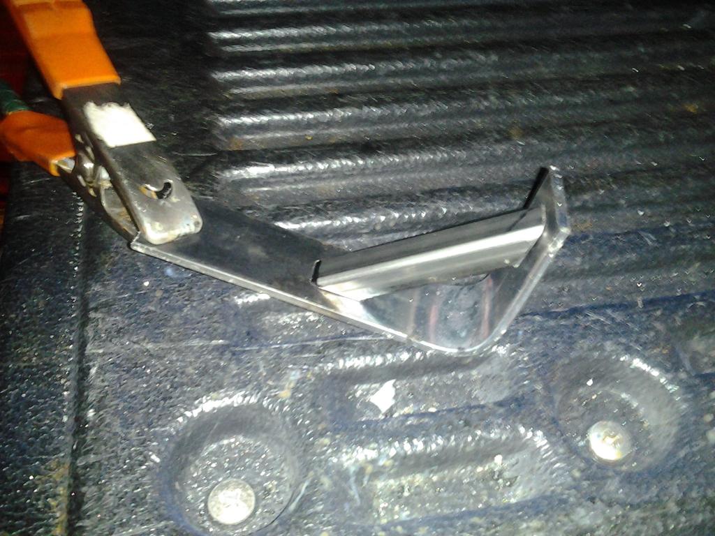

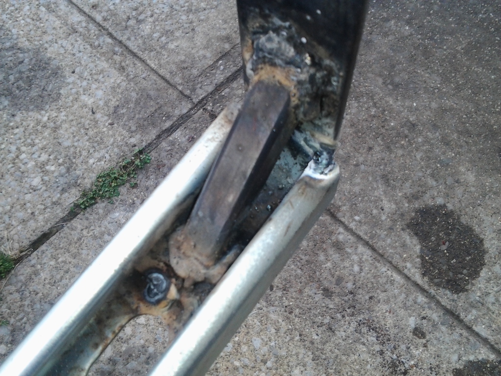

Hey guys, just finished the fab on my light bar today with a little flat black rattle can and a couple 55watt lights. I started with some 1.25 width 1/8" thick flat stock, a piece of 1/2" square tube stock and a 15' piece of 1" Superstrut. Everything purchased from Home Depo about $40 for the steel. I cut 2 pieces of the 1.25 flat steel and bent a 90(with heat) on one end with about 2.5" that would slide into the Superstrut. Then lined them up so they had the same vertical length and with more heat I bent a slight angle on the portion that comes in contact with the truck. I then cut 2 pieces of the square stock at 45 degrees to weld inside the flat stock to give support at the 90. Then I drilled two holes in each mounting piece to screw into the door jam above the rain gutter. After screwing them on I measured the distance between the two mounts and cut the Superstrut to length. I had to trim a little off to make it square to the truck but better to long then to short. Welded the Superstrut to the brackets I fab'd up, welds inside the strut and threw one of the holes. With the pattern of the holes on the strut you should be able to center the lights.
Mounted on 1993 Pickup

Ok finally figured it out, or the best I could anyhow. I still need a little work on my welds but they are always strong never pretty.

Thanks for fixing the pics. Yeah the doors do cover the screws. On my 99 Taco I had a Carr Light Bar with the brackets that had to be screwed into the truck, that gave the brackets something to sit on and clamp to, so wasn't to worried about putting holes in my 93. I don't know what you could clamp it to, not much around the top of the door opening to get clamps onto. I did put silicon in the holes and all around where the bracket meets the body, and over the screw so if i need to remove it the screws shouldn't get to rusted. Only problem so far is its a little noisy on the freeway, sort of a howling sound. One thing I would do different would be to angle the brackets in towards the center line of the truck, from straight on the light bar looks a little funny, only because I remember how the Carr looked. Good luck with the build Jimbone.
