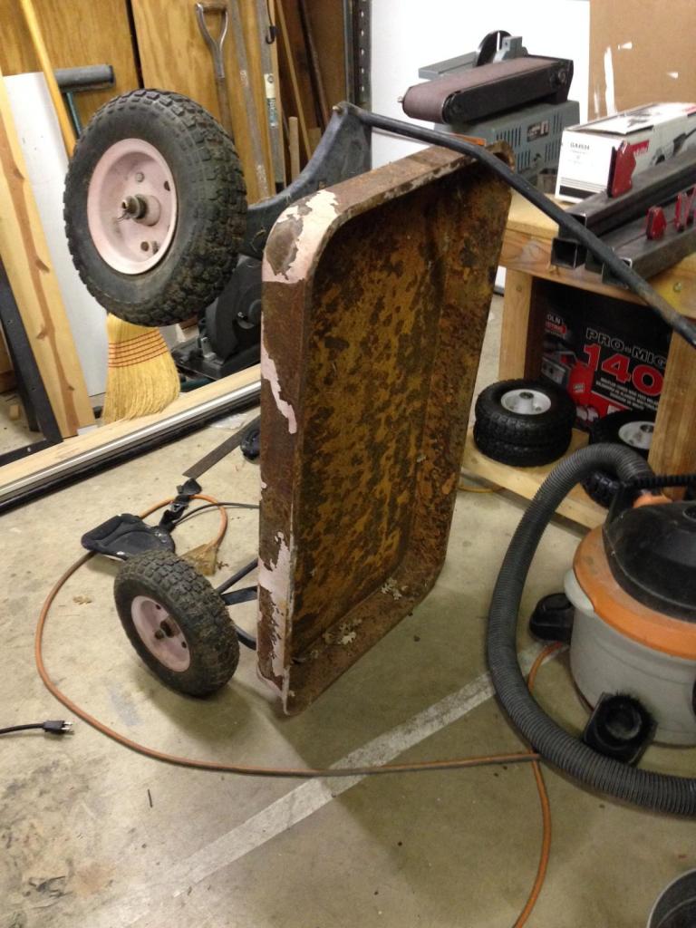

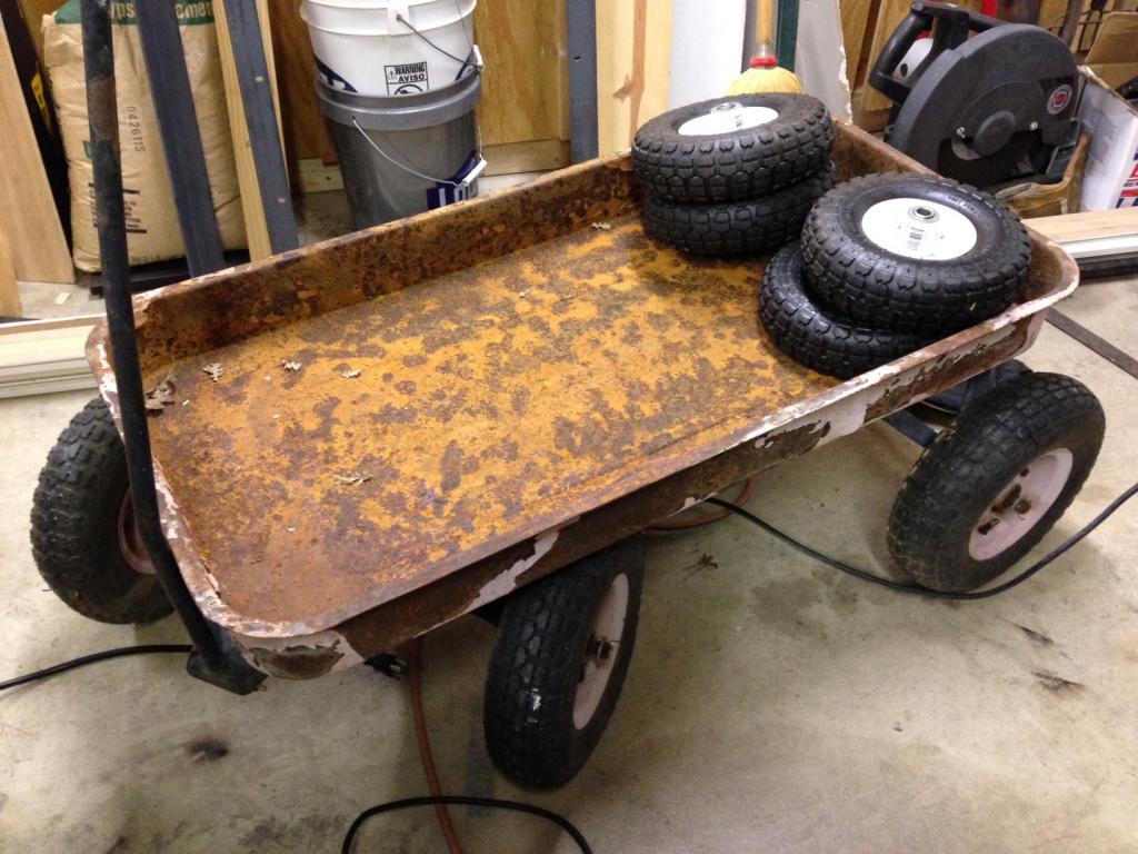

Thought I'd share the wagon project I just finished up last weekend for my 14 month old son.
Was looking for an old wagon on CraigsList when I came across an ad for a $10 rust bucket wagon that came with a 2nd set of brand new wheels/tires. I figure it would be worth it just for the 2 sets of tires even if one was bad, because you can't even buy them at Harbor Freight for that cheap. As the Guy opens his gate he comments that it will be interesting getting it into my Corolla. I'm thinking "what? a kids wagon should fit just fine". Gate opens and I see perhaps the largest wagon I've ever seen.
Guess he should have at least put something in the pic for size reference or included some dimensions in the ad. The pan is 22" wide x 42" long x 4" deep, and rides on 13" wheel barrow tires. Pretty much big enough to fit 2 adults! It's not a Radio Flyer though. Guy said he was a lineman and found this wagon about 15yrs ago sitting in waist high grass under power lines in a field, which is why it's so rusty. He stuck it in the garage for a future project that never happened.
My new $10 CL purchase:

I decided to rebuild the wagon after all. Decided it needed to have "safer" steering, because I got bailed too many times as a kid with the flip around steering they put on old wagons. I was very tempted to get crazy and put it on suspension - but after looking at prices, I decided I should just build an actual go kart if I'm going that far....so I guess I have another project someday...

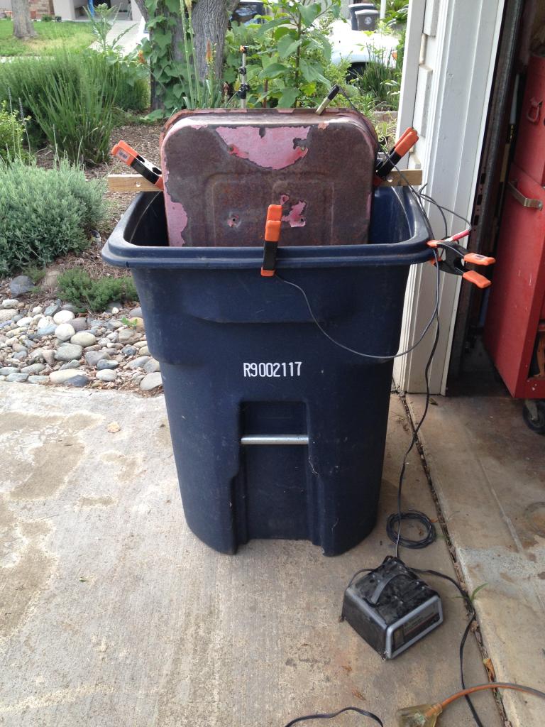

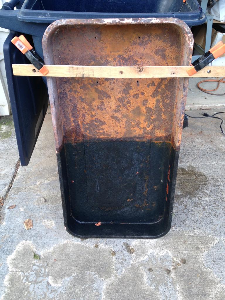

After calling up a few places to inquire about having the pan blasted ($100+) I decided that was way too much money to invest in this project. I consulted my neighbor who works on old cars (working on a mid 30's Chevy now). He mentioned electrolysis is a common practice for old rusty steel objects....so did just that in my city recycle bin:

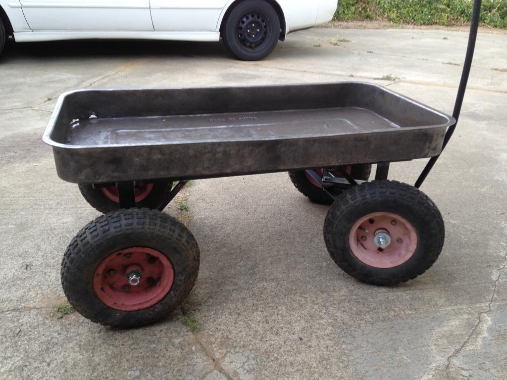

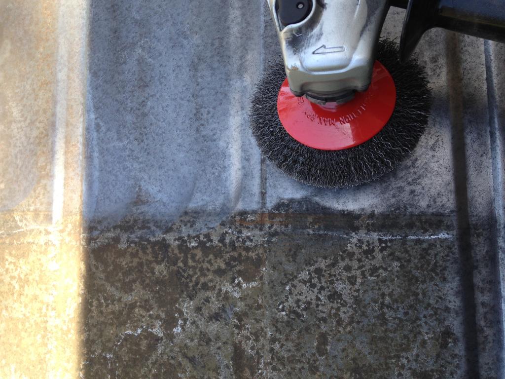

Wire wheeled it after the electrolysis was done. Didn't remove all of the rust and paint like I'd hoped, but it was my first time and I left lots of room for improvement. Unfortunately, found a few pinholes that rusted all the way through, had to weld and grind all those all shut.

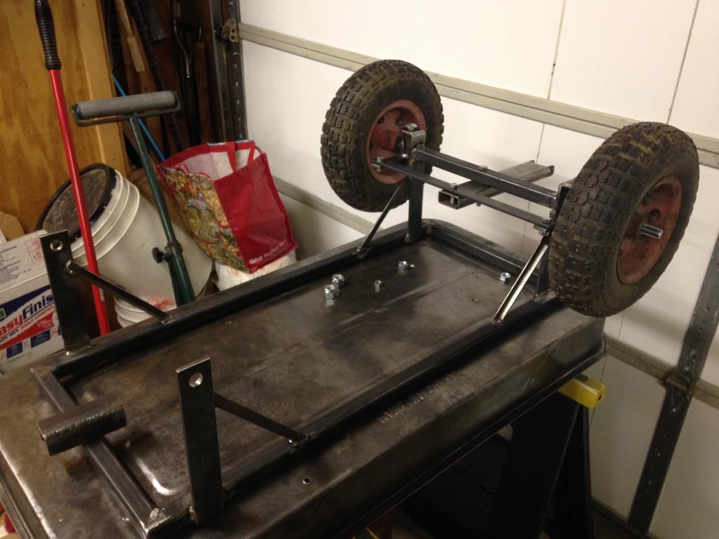

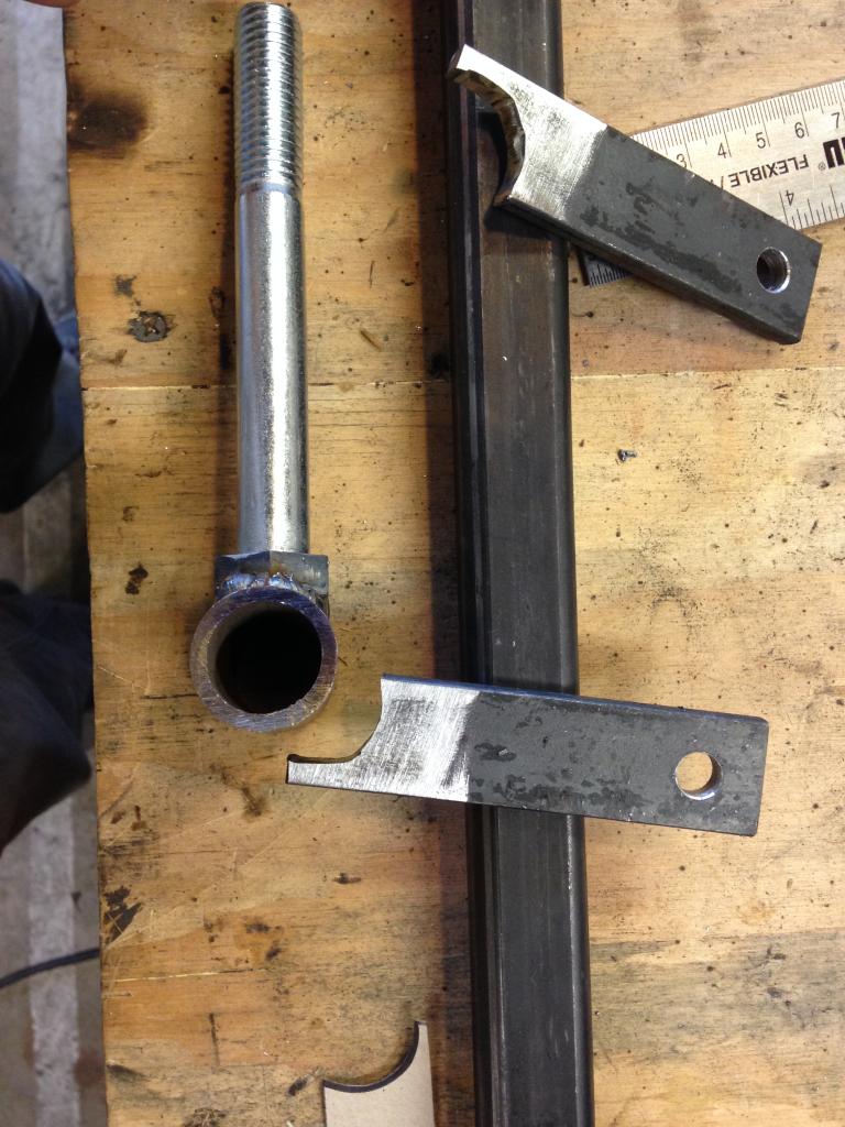

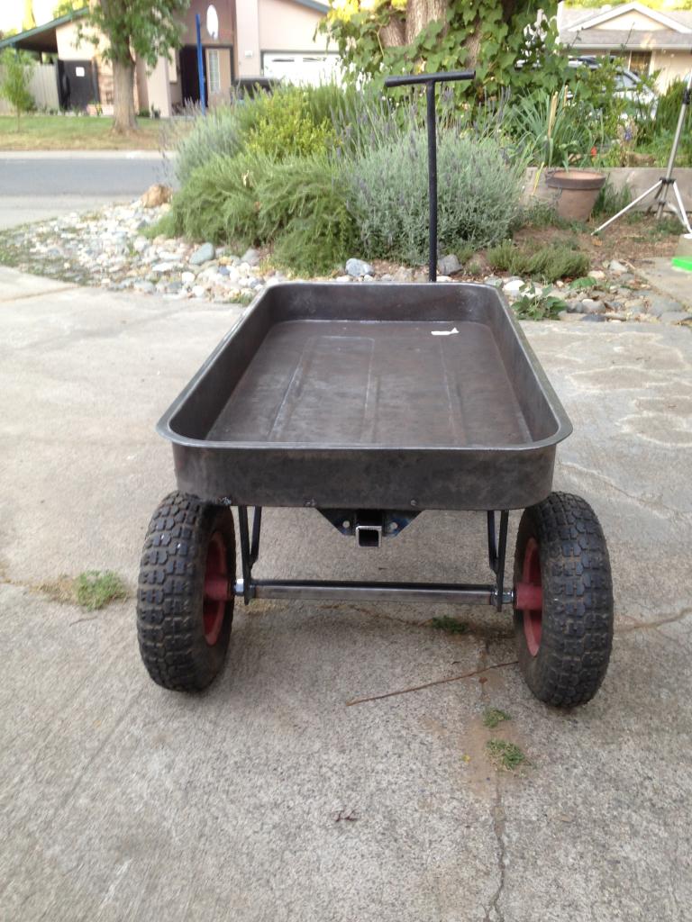

In the meantime, I was working on rebuilding the steering and actually putting a frame under this huge pan so an adult wouldn't "taco" it.

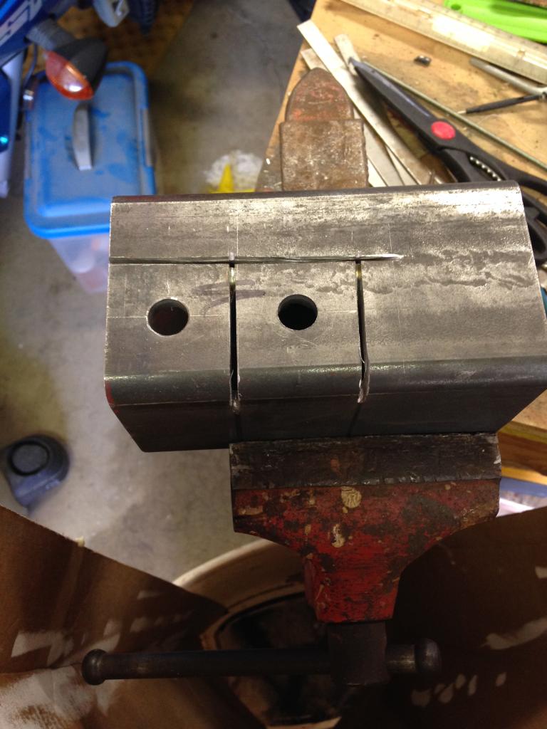

making my own steering parts - I should have just bought some go kart weld-on parts from eBay instead:
Mock up

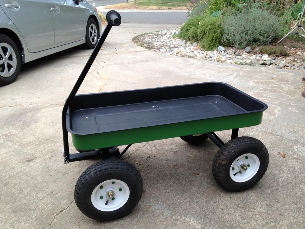

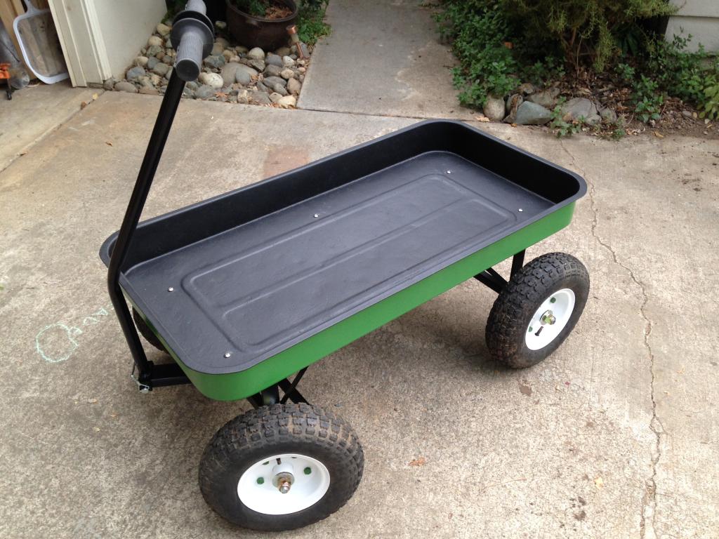

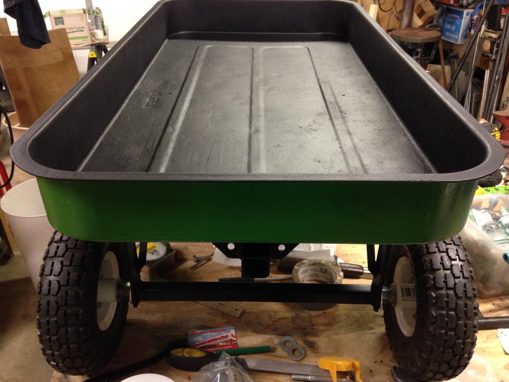

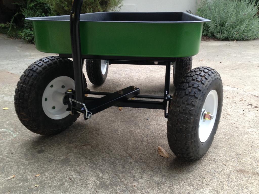

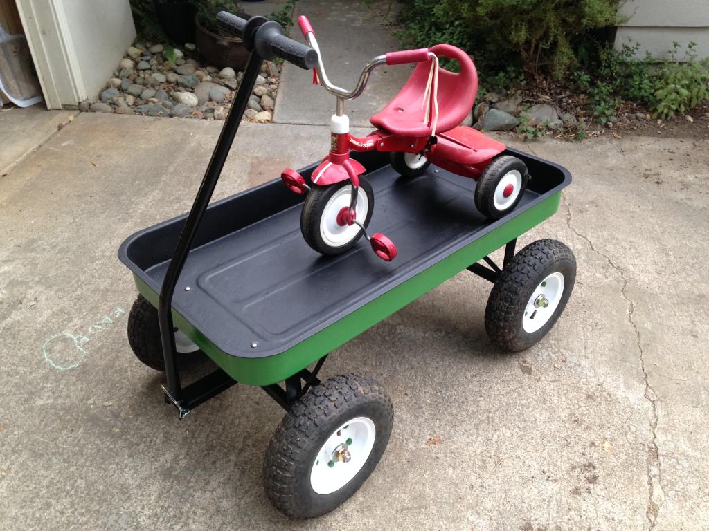

Finished! Decided to go with Duplicolor paints: John Deere Green, Black Bedliner, and White. After putting it all together, looks like I forgot to paint the washers and axle nuts green, oh well.

Awesome job. I noticed the trailer hitch before I saw you commented on it. Now it needs an engine.
Old Aug 4, 2014 | 01:09 PM
rustED's Avatar
Joined: Sep 2010
Posts: 2,716
From: Tri-Cities, Wa
That thing turned out sweet, nice job! Especially like the custom crossover steering, lol, big improvement over the old school steering! Did you use a battery charger for the electrolysis process?

Yes, just a simple battery 2A/6A charger I had sitting around. I went with 6A setting, but it didn't always read that high. I think the draw has to do with the strength of the electrolyte solution. It definitely worked though.
My neighbor was telling me some car guys go as far as buying an above ground pool - install the floor, roll car in, put the up the sides, fill it up, do the electrolysis with daisy-chained car batteries, then take it apart to get car.
If I had access to a pressure washer, I'd have actually tried that first for the prep work. I helped my dad repaint some patio furniture 2 weeks ago - we cleaned the chairs and table up with a 0* tip on his pressure washer and man that thing can seriously strip surfaces! Not sure if it would have warped the large areas on the wagon or not, but it possibly would have blown out the heavily rusted corner beyond what I could easily repair by tack/fill method.

Love safety chain slots on the little trailer hitch.. Nice work on an old wagon!
