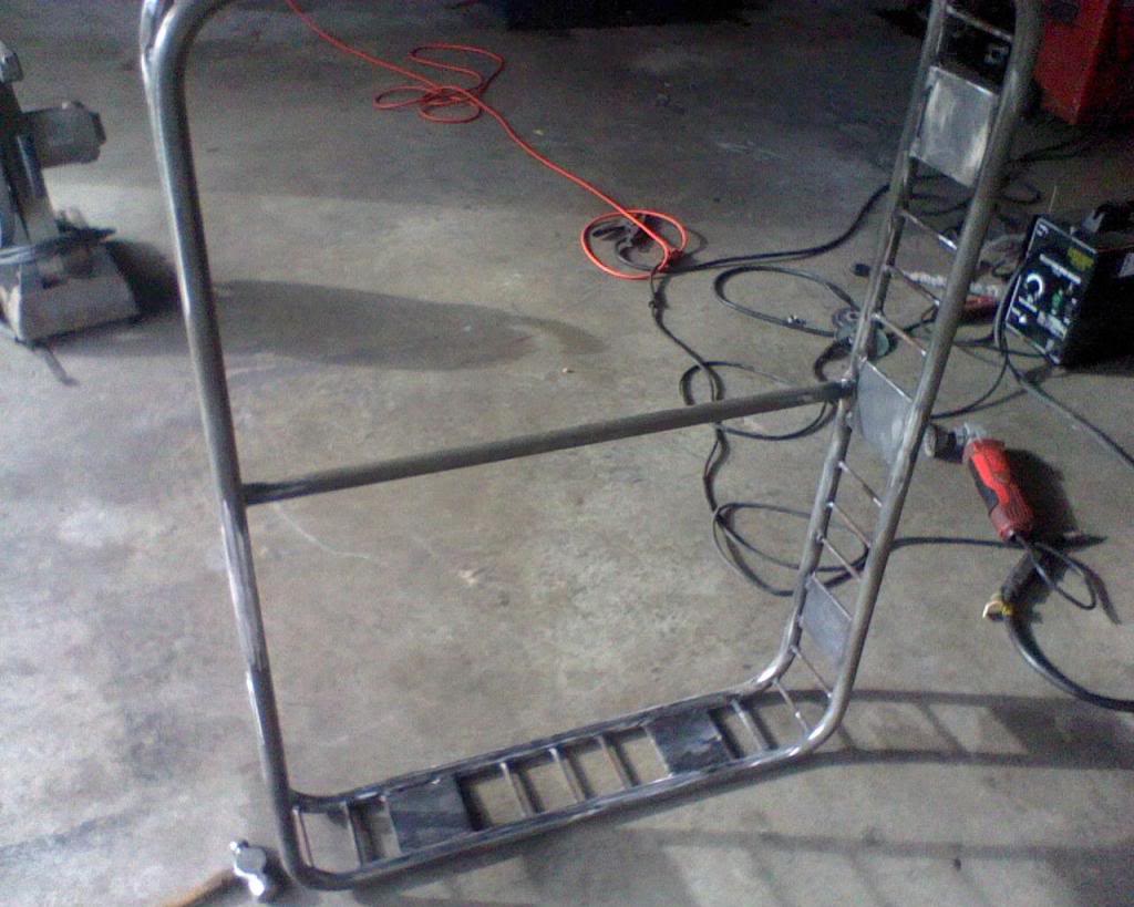

Well getting everything the way want it takes a little longer then you might think After much grinding and more welding I am ready to move forward with my episode here.
I started by grinding all my welds and re welding almost everything.
had to make sure everything was kind of decent...
After all the work it was time to put a support bar in.

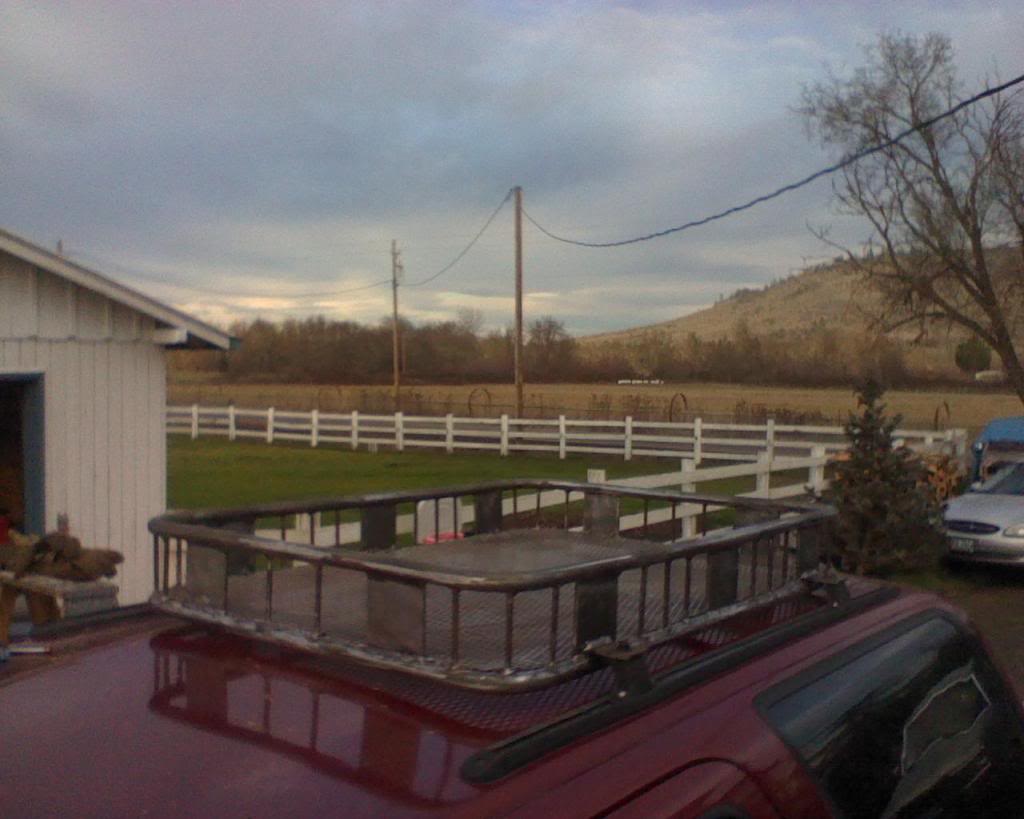

Then I fit in the expanded sheet metal..

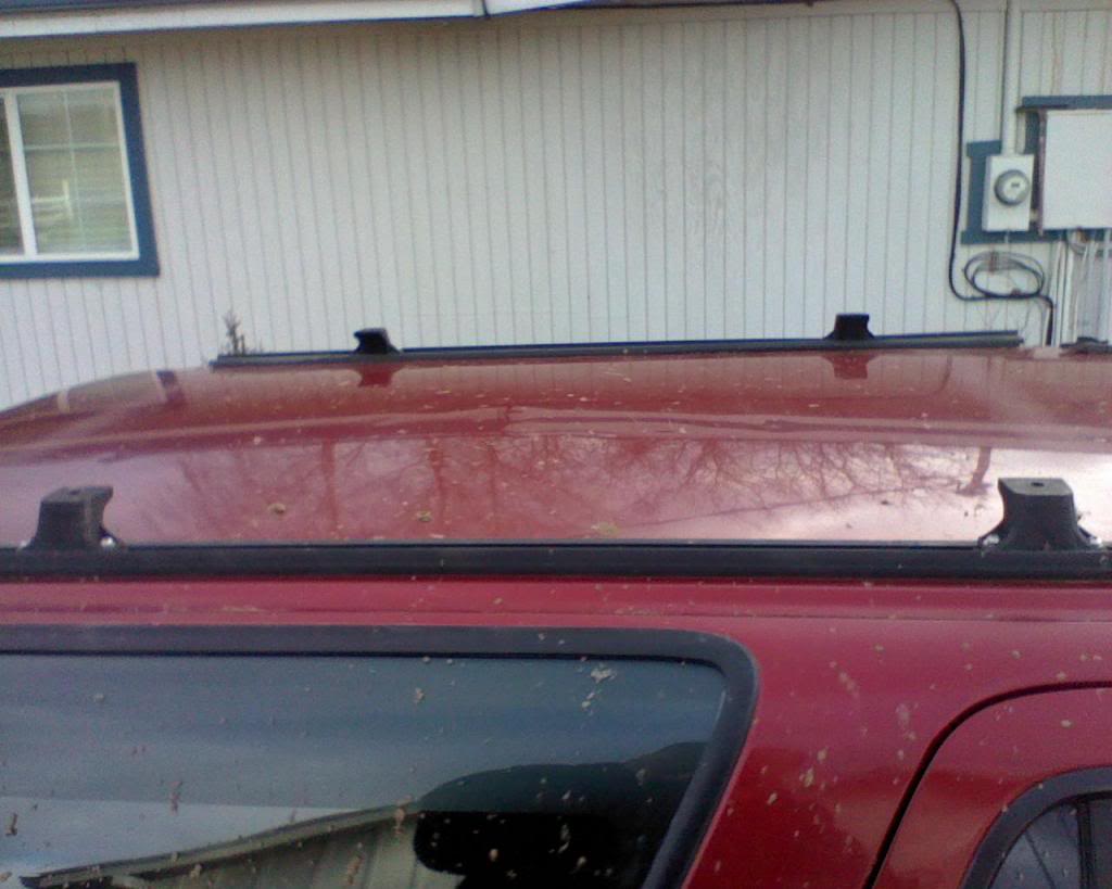

My plan is to use the existing mounts on my old rack.

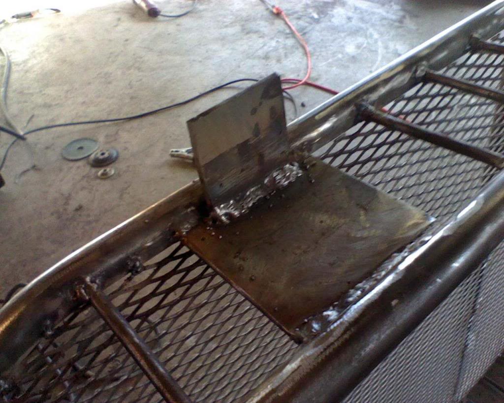

So I had to make some extension brackets to mount the rack.
Putting the brackets there brought the height of the rack down to where I wanted it. Not to tall but a little clearance off the roof.,.

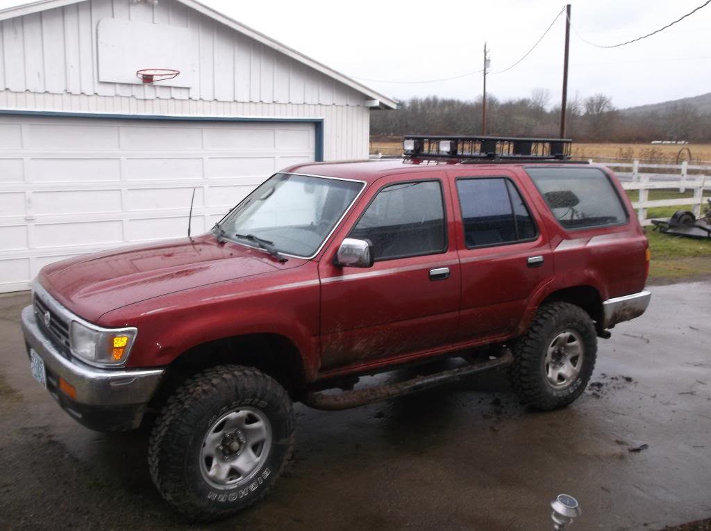

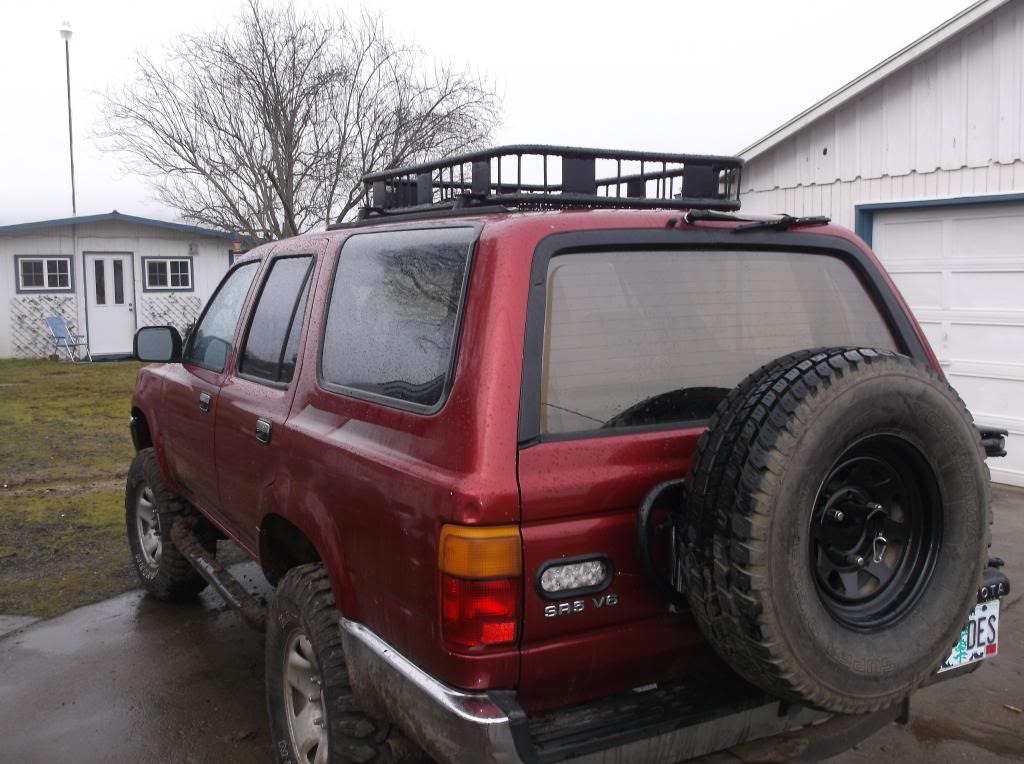

Sick but finished....

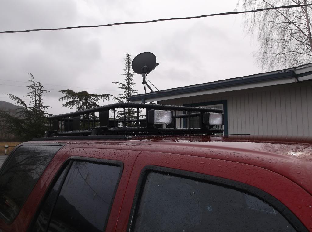

Well My whole family got sick took us all out in one fell swoop! But I have finished painting and mounting the lights. I think I like this look and have decided against the plate idea for now. So without further delay heres what it looks like finished.
In the future I plan on adding 2 more lights. I hope you guys enjoyed the build sorry the last part took so long but sometimes life throws you a turd

Sweet. I like that it is very close to the roof

Looks really good. Only thing that I do not like us the size. I believe I'd made it a little wider and longer just so it would cover more and offer more storage. But that's just my opinion. I really do like it tho. Good job
