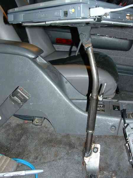

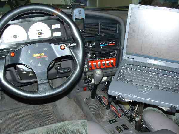

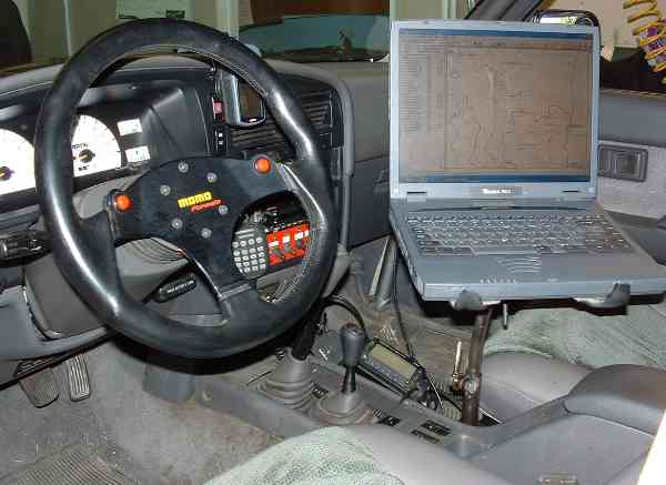

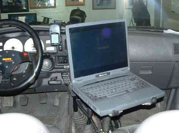

Ever since I recieved a GPS unit for Christmas I've gotton really into this stuff and since I love playing with gadgets and going on trips, this stuff was right up my alley. So I picked up a good cheap LapTop on eBay to help with maps and memory needs and of course I can watch DVD's, play MP3 files through my system and a few other things. So I needed a Off Road wherthy Laptop mount that could stand-up to abuse so I did some reseach here and on the Web and couldn't find anything but ones that cost $200 dollars that cops use to $25 cheapie's on eBay. After seeing what was out there I decided to build my own so it would stand up to off road and even though I could get the $200 unit, and I'm sure that this one and other's can handle off road, I thought for $150-$200 I could build my own.
So Here's what I built.

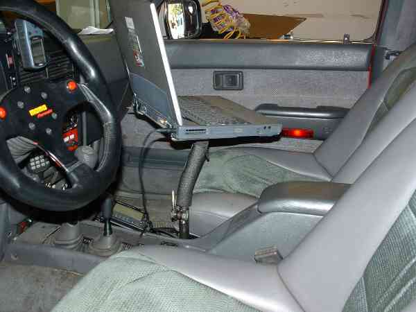

It took about 4 hours and about $30 to build. One thing that it needed to cleared all controls and be ajustable up-down and turn back and forth with being easy to remove.
Attached Thumbnails GPS / LapTop Off Road Sturdy-Mount-adjustheightdown.jpg   GPS / LapTop Off Road Sturdy-Mount-adjustheightup.jpg   GPS / LapTop Off Road Sturdy-Mount-mountremoved03.jpg

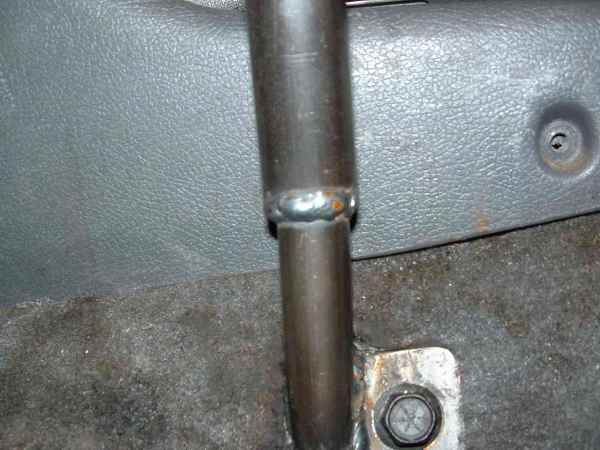

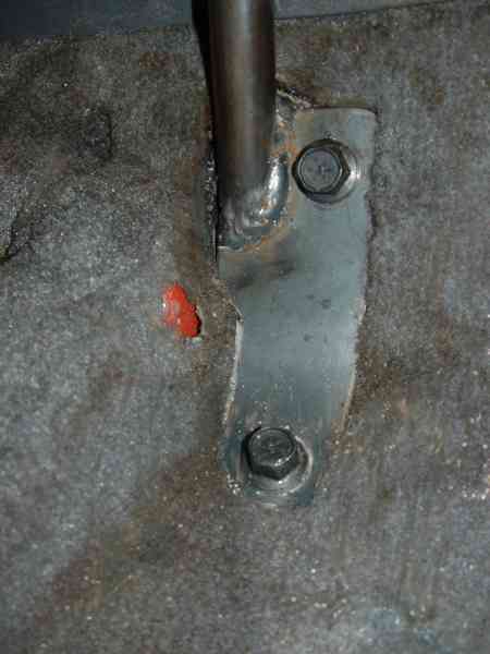

1. The first thing I made was a simple Base plate and formed it to the floor then mounted it with 3/8" nuts & Bolts. pic#1

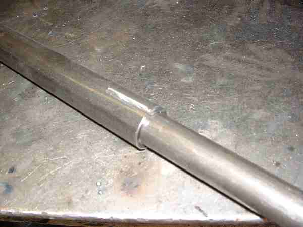

2. welded a peice of 3/4" X .120 wall 4" long cut at 60 degree angle (guestamation) to base plate.Pic#2

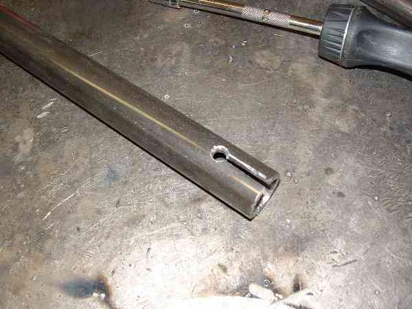

3. Took a peice of 1" .120 wall tubing (3/4" tube slips into this) and at one end I used a cutting wheel to split a slit about 1-1/2" long that would be used to clamp the 3/4" tubing. Pic#3
Attached Thumbnails GPS / LapTop Off Road Sturdy-Mount-floorplate03.jpg   GPS / LapTop Off Road Sturdy-Mount-buttweldsleve05.jpg   GPS / LapTop Off Road Sturdy-Mount-slipfit04.jpg

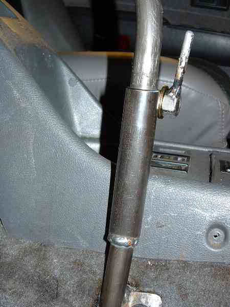

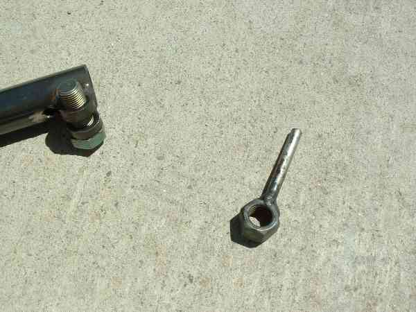

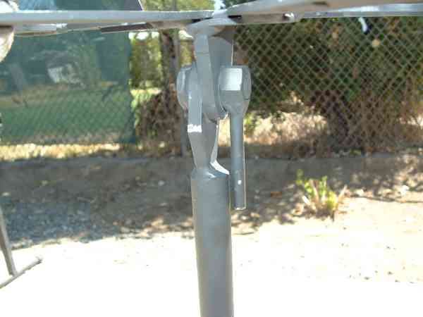

I used pinch bolt set up to hold everything tight and welded a rod on a nut to add leverage for locking and unlocking the motion of the arm
Attached Thumbnails GPS / LapTop Off Road Sturdy-Mount-tubingsliced.jpg   GPS / LapTop Off Road Sturdy-Mount-clampsetup09.jpg   GPS / LapTop Off Road Sturdy-Mount-clampsetup12.jpg

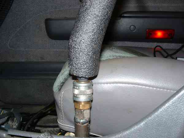

Having the 1 '' tube butt welded a little off center to create a stoping point for the slip fit 3/4" tube. This seemed to work better then just using a longer peice of 1" that would allow the slip tube to go further causing it to bind at the bend making it hard to remove so I did this for a bottom out point.

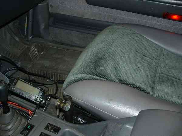

I also started out using an air fitting to use as the swivel and quick release and this was fine on the street but when I hit the dirt it whoopled to and it had no way to lock it in place so I decided on the clamp lock set-up.
Attached Thumbnails GPS / LapTop Off Road Sturdy-Mount-airfittnmount07.jpg   GPS / LapTop Off Road Sturdy-Mount-finishedmount09.jpg

So now I have no whoples and it fells solid, and I'm sure there's better way's to do this but for the money and time this works for me now. If I where to do it again I would of used mild steel instead of chromoly for the reason mild steel is softer and would be less effort to clamp where chromoly is stronger and take alittle more effort to clamp.

Yeah I know what you mean, I had hinges come loose and the screen started to get a little floppy, There are 2 screws to tighten the hinges up and that seemed to fix it for now. And now I keep it closed while off-roading and I can still view my little GPS LegendC screen and then when I stop I open it up. I also noticed it works great as a table when closed. Red and White checkered table cloth anyone...

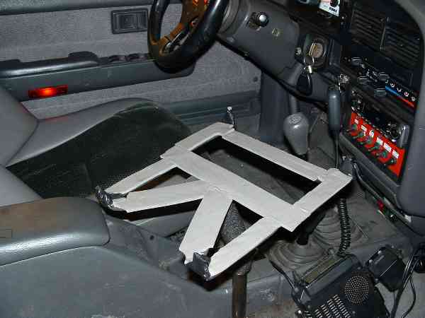

For some shocking I used foam weather strip tape on the tops base and a Velcro strap runs around the LapTop to keep in place. Also when I mounted it to the floor I left the carpet between the floor plate and floor which allows for some shocking (cheesy way) and doesn't cause whooples even though it has a little movment.
On the top I decided not to use a solid peice of material instead I used 1-1/4" X1/8" steel strips (Home Depot). I thought this might work better to help with keeping the LapTop cooler with more air flow.
Attached Thumbnails GPS / LapTop Off Road Sturdy-Mount-finlaptopmnt022.jpg

No, Not at all, in fact the last couple of trips it's been real handy for the passenger to read the laptop and makes it a little more fun for them as a co-driver / navigator. Also it's adjustable for larger passengers and swivels up-down, tilt and side to side.
