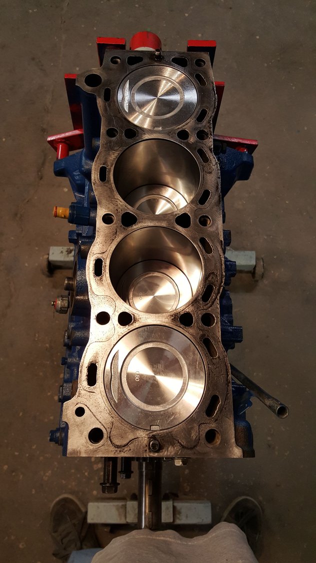

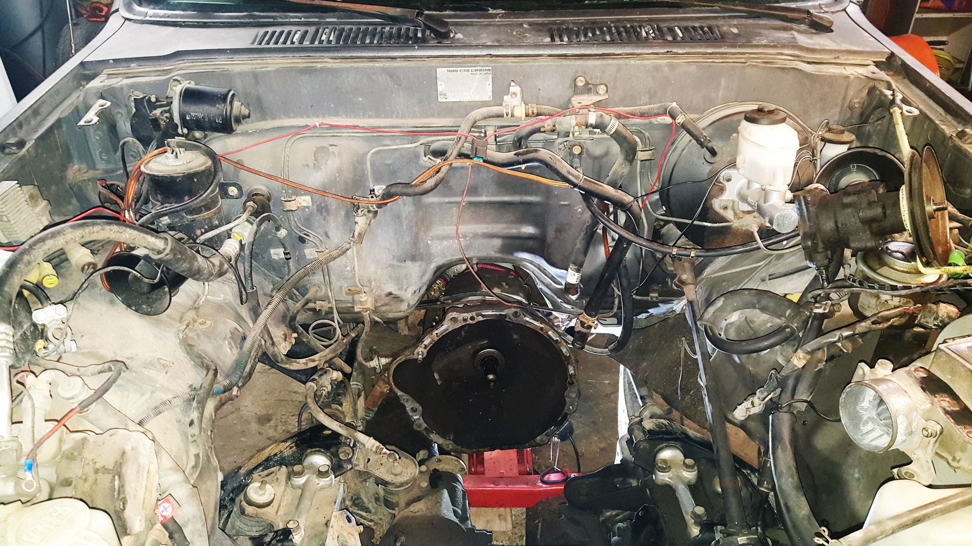

A few months later i decided it wasnt enough so out came the 300k+ mile engine. I considered the 3.4 swap but wanted to keep my 1st gen more original and decided to rebuild the engine myself. This was a monumental decision for me as i had never ever even taken a motor apart let alone rebuild one. The Cam change I had done was even a stretch for my abilities.
But it was gonna happen.....
I wanted to have a bit more power but nothing over the top so I decided to go with a mild build up on the bottom end. Off to the machine shop it went for a good clean up and to bore it out 30 over.
Ended up going with a quick valve job to the head with some oversized SS valves from engnbldr and his Street RV head kit as well as his rebuild kit for the engine.
My rods were a little bit worn and ill be honest i dropped one and screwed it up so I also decided to get some LCE Street H Beam Eagle rods as well.
More on that later.....

After I got the engine installed it was time to address the brakes. So in went the rear disc kit from All Pro.
Those sure looked pretty.
It was at that point that i decided since i had to take the axles off that I might as well install a locker in the rear, so i decided Detroit seemed to know what they were doing on those and in it went.
Also decided it was time to lift the rear a little bit to make it set better with the front kit. So I went with the All Pro 5" rear kit. Worked out perfectly.
