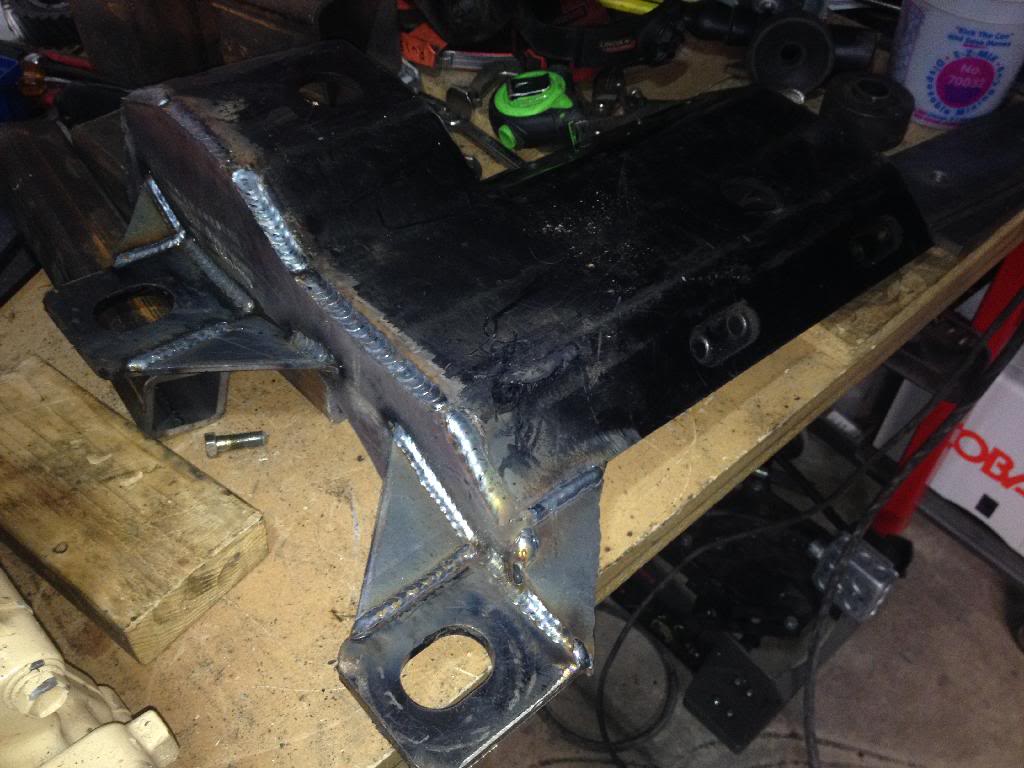

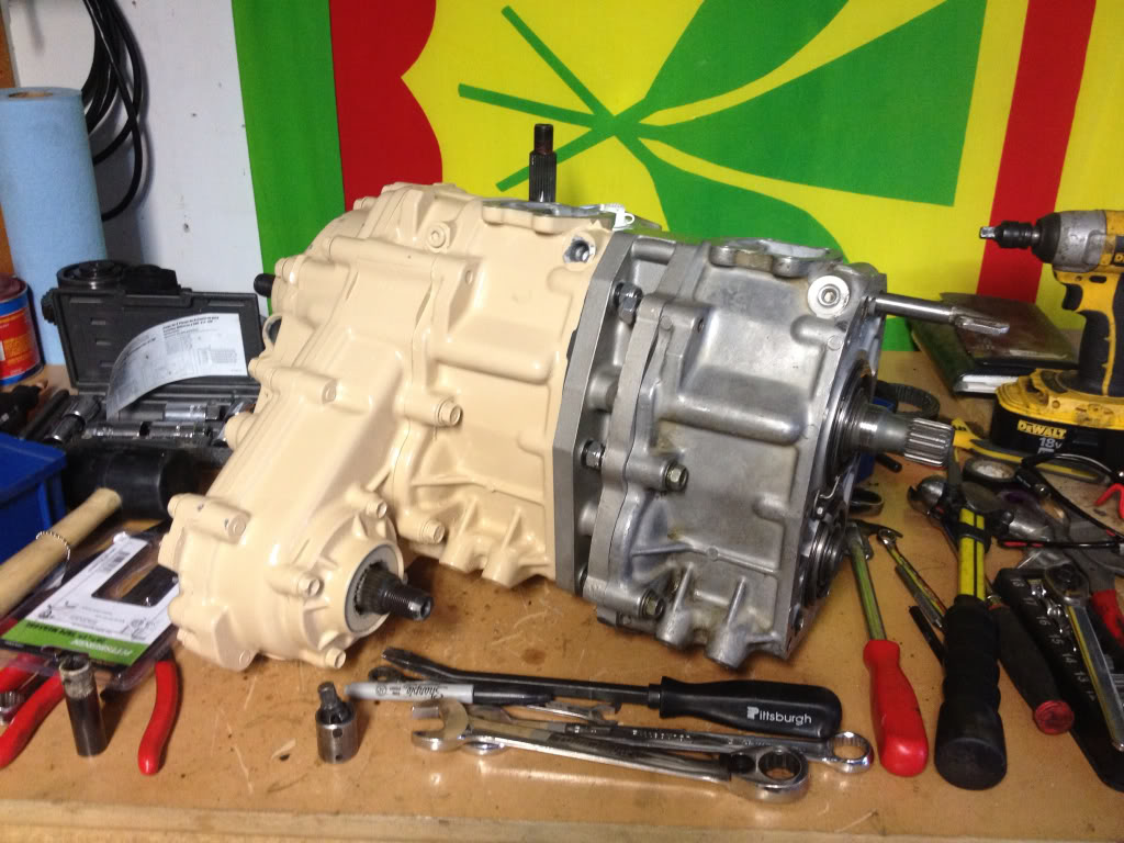

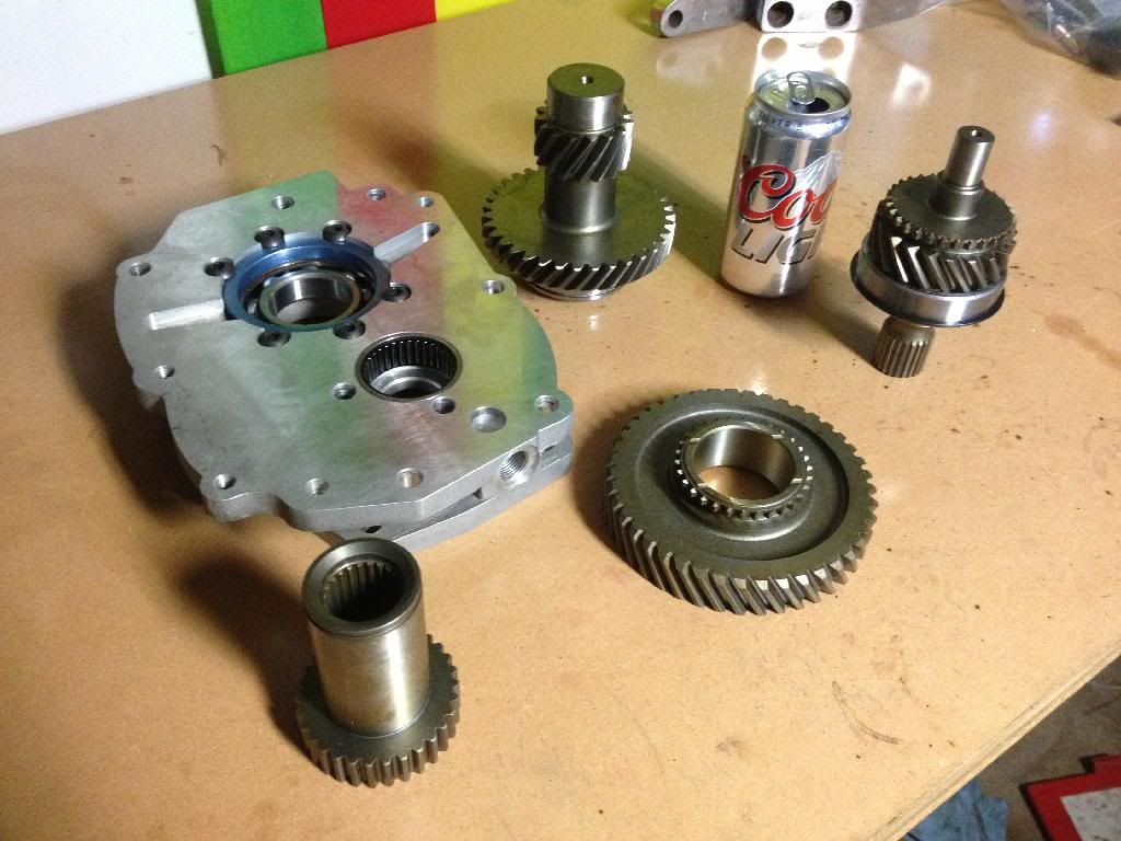

Decided to build my own crossmember for the duals.
adapter and 4.7s from TG
Fresh

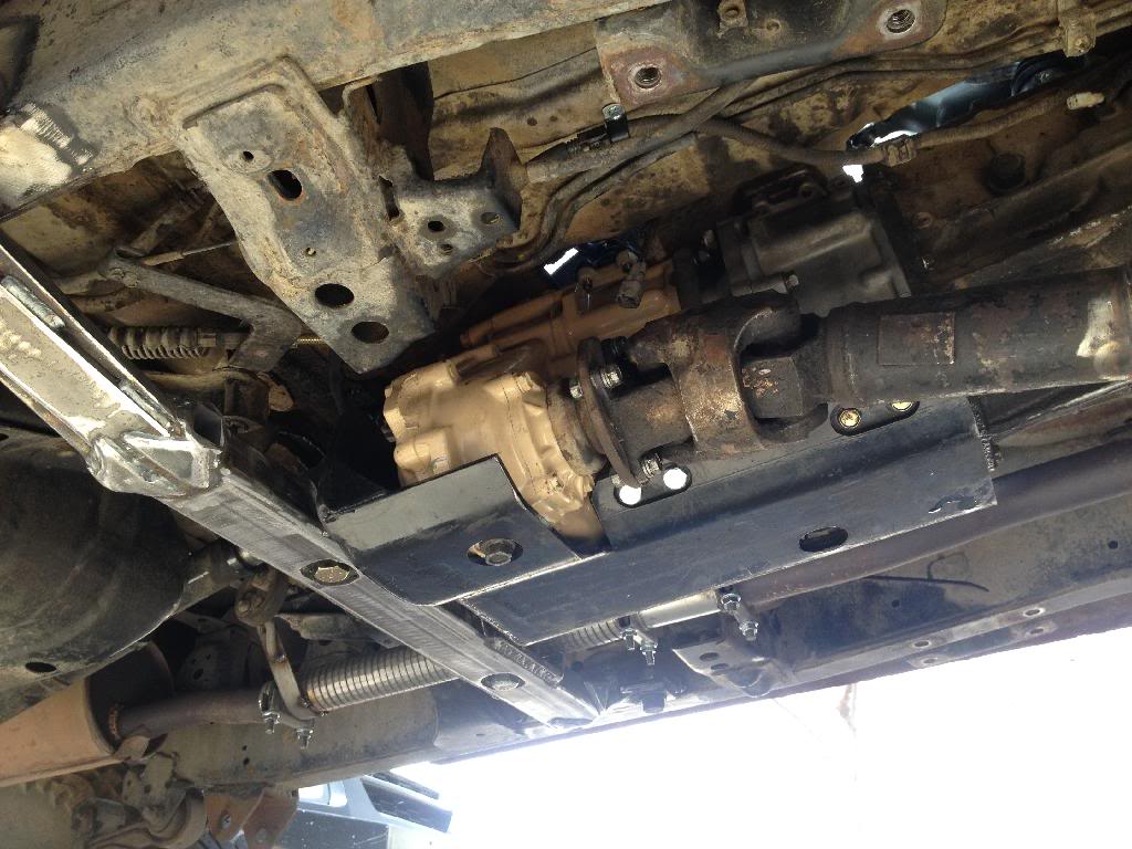

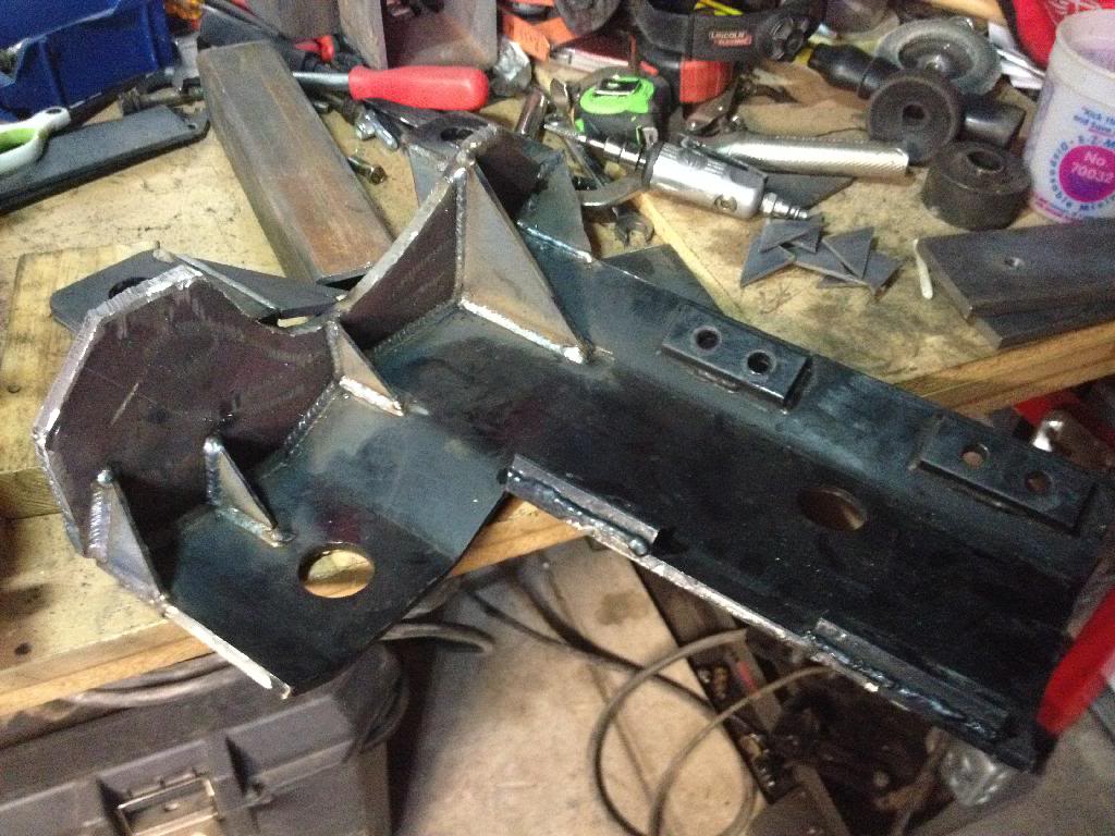

Used my old FROR skid. Was gonna reuse the collar that bolts to the rear of the case, decided to try something different.

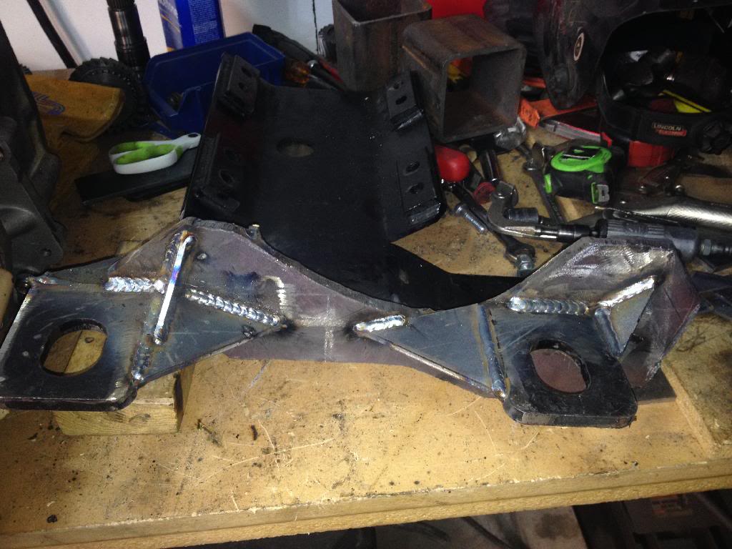

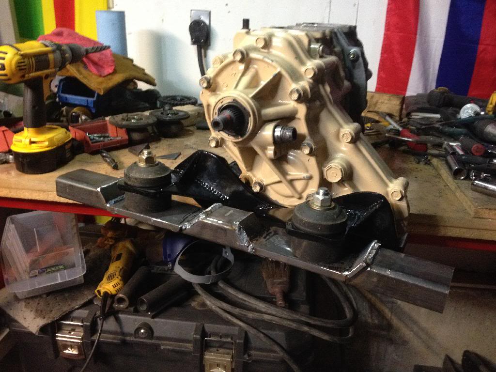

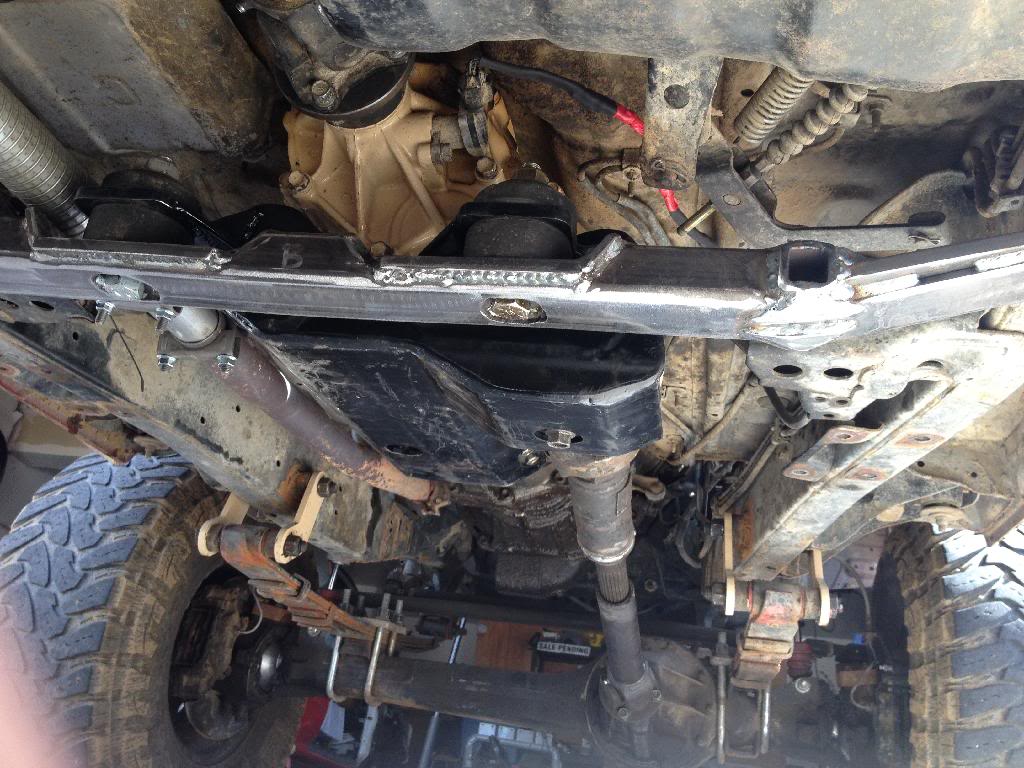

Start of the actual crossmember. Used the old softer bushings

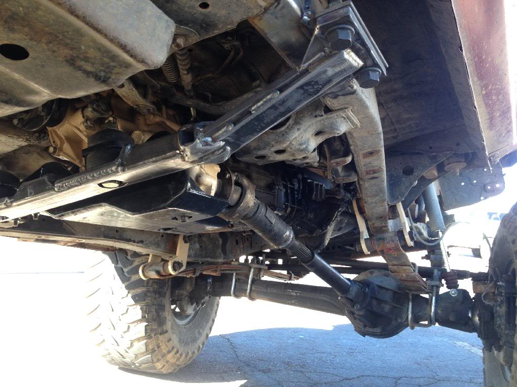

Pushed it up as far as I could without hacking the floor.
The exhaust is temporary untill I install a header.
So far everthing works fine, hardly any serious vibes. Hopefully everything works when I actually wheel it hard this summer.
