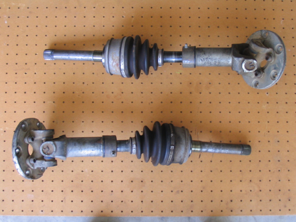

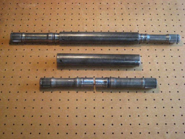

Here are a few photos of some custom CVs.
This is a set I built from a standard truck and 4Runner assembly. I cut and lengthened. For the sleeves I started with a section of 1-1/2" DOM with a 1/4" wall thickness. I turned the I.D. to pres fit the cut axles. I then plug and perimeter welded the sleeves to the axles.

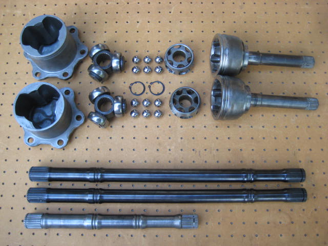

Here are the donor parts from the truck and 4Runner loose. Below that is a pair of new center bar axle shafts I had machined. A stock unit is shown at the bottom for a reference for the length increase.

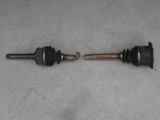

Here is a mock up built from thin wall I purposefully twisted up after they served their purpose.

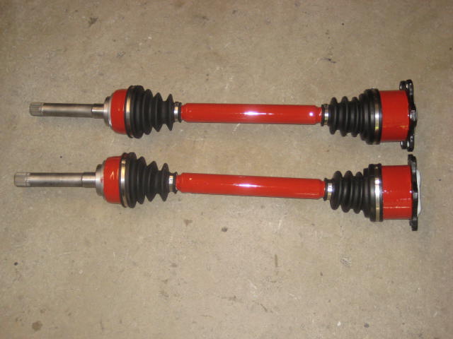

Here is a set of Downey high angle slip yoke axles.

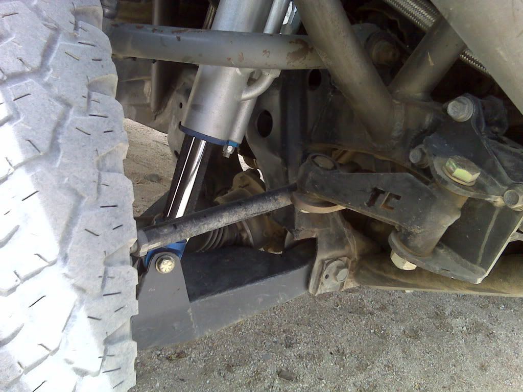

First post here. some food for thought.
I used a 930 cv for the inner joint will usually get 28-29 degrees of articulation over the lower 23-25 degrees of the stock T100 axles. I guess this isn't really all that necessary if you're keeping the upper control arm with a ball joint. It has lasted and extremely long time on my 92'.
pics for refrence:

The 930 CV comes from the Porche world and has been used in desert racing for a long time. Pretty readily available to the average consumer you can even upgrade the cages inside to a polished and relieved style to add longevity. The travel kit I have is only spec'd out to be 13" of travel and without the axles it will cycle more than 15". The axles were definitely holdingthe front end back so, i went this route. Did I spend too mich money? Yeah, probably lol. About $100 each cv and I had adaptor plates machined as well. I can't remember the price on that though.
