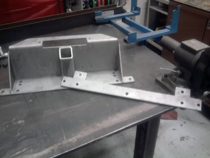

simplest, cheapest, and best looking bumper i would suggest you buy a TG winch plate for $150 and expand off of it. it saves the engineering and headache involved with figuring out how to mount the bumper - just bolt it on, make a template for the rest and start tacking them on. the rest of the bumper can be made from probably $50 in steel plate.

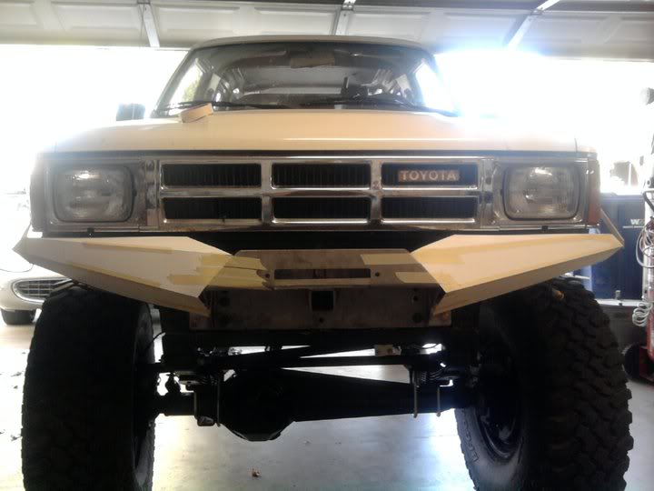

here's a really good example of what you can do. very simple design. it's what i'd like to put on my truck someday:
stupid simple design. all it is is the TG center winch mount and 6 angular pieces of plate welded to it. from here you can add bull bar or light mounts, cut holes in it for lights, add a beefed crossmember support (ex: lowrangeoffroad) or whatever you want. grind all your welds flush and follow up with a DA sander and you can't really tell it was made from individual plates vs bent.
heck, this is almost a template to follow:

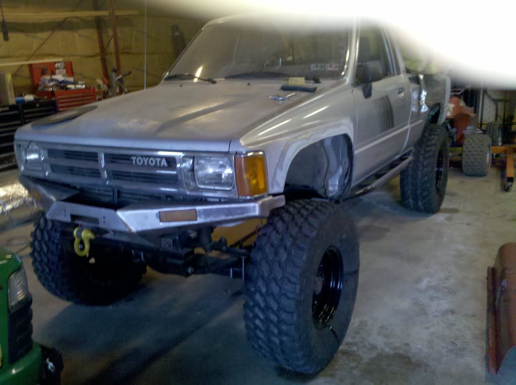

another based on the TG winch plate:

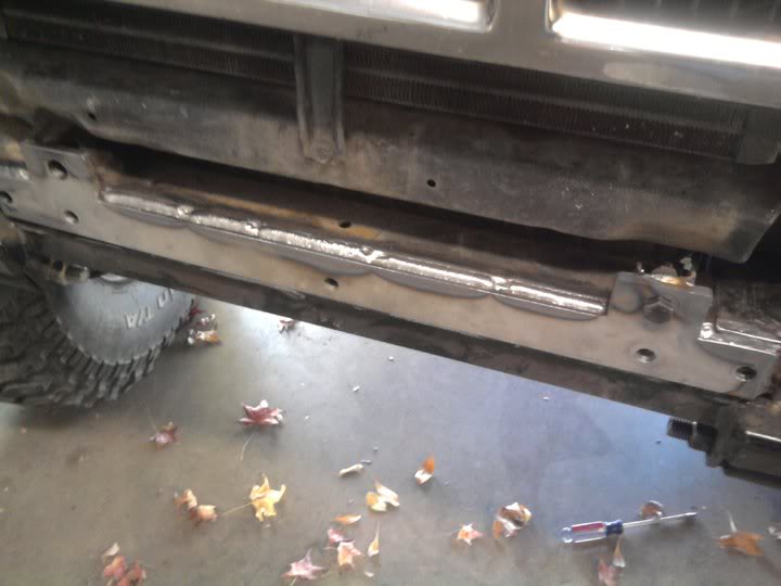

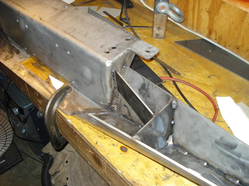

but more important for you inside that thread are these (same bumper pictured in my last post):
