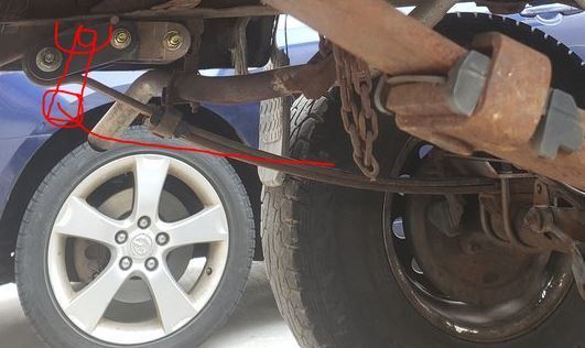

Did you end up correcting this? IF you dont want to move the front hanger and shocks and stuff, you could just add a different rear mount and ditch the double shackle.
This took me a few hours to draw up, but im pretty good a photo shop so I enjoy it:

Looks kind of phallic and like it's doing something crude to the tire.

I haven't yet, I was out with the rona and couldn't go into the welding shop. Hopefully I'll get it done next friday! I'm planning on moving the front mount forward because moving the rear mount back would push the axle farther back than I'd like, but thanks for the suggestion! Haha your photoshop is on point! Thumbs up
