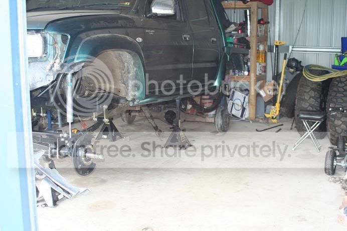

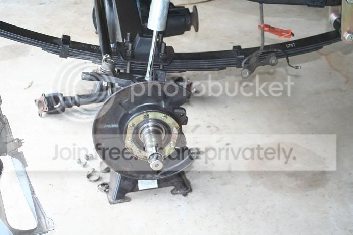

Well with a huge thanks to Dan, Buddy and Ryano the lux is done
I still have a few things to tidy up and clean up etc. I also stuffed up the rear driveshaft length but it is out of the shed and looking flaming insane. Anyway enough crap heres the pics.
Dan got here early so we finished off the final welds on the front and made a start on the rear.
From there bubs showed up with the spacers and we got the front done.
Standing on its own feet.
The rear inverted shocks
