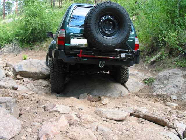

sweet, lets see some pics of that tire carrier, pleaseeeeee

here you go Rick! hope these will do?
H-man

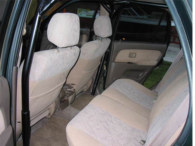

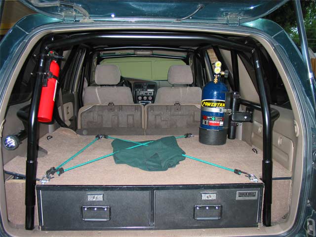

Attached Thumbnails 3rd Gen internal cage-carnage-can.jpg   3rd Gen internal cage-twisted.jpg   3rd Gen internal cage-rear.jpg

more interior pics
here are some more!
Attached Thumbnails 3rd Gen internal cage-driver-front.jpg   3rd Gen internal cage-passenger-front.jpg   3rd Gen internal cage-left-rear.jpg
