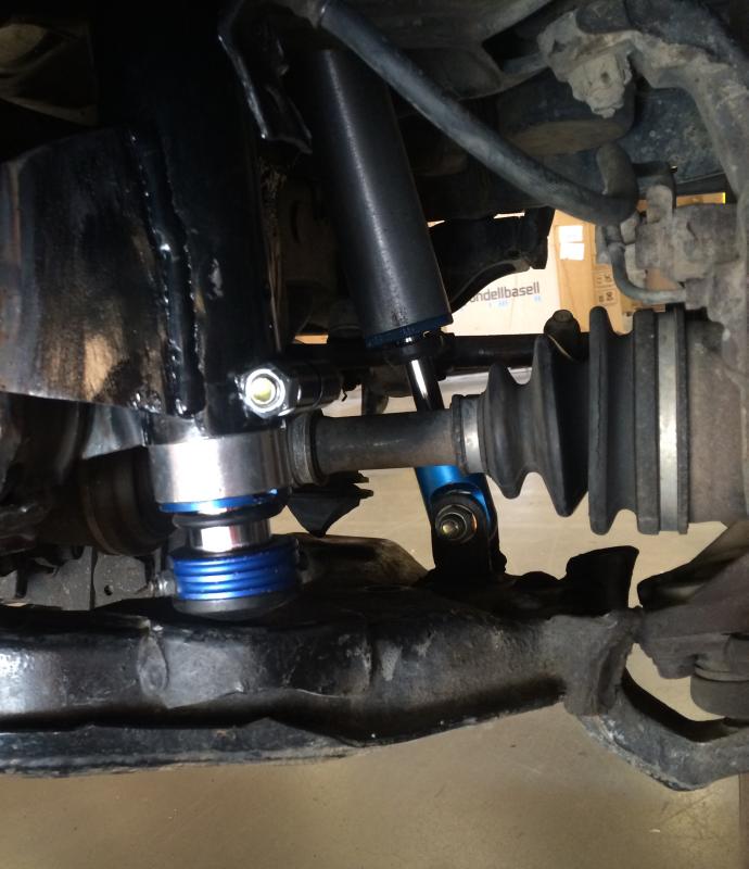

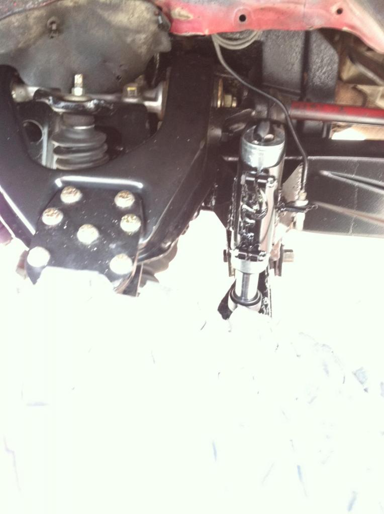

I left my front bump stop but shaved it down to make contact at full bump as a safety precaution of my hydros blow out. I mounted my 2.0 fox bumps off the frame behind the UCA to contact the existing strike pad on the LCA. thought this cleaner than doing it off the front of the arm. Hope this helps.

It works well. I have stock arms and can keep up with most guys with mild LT kits.

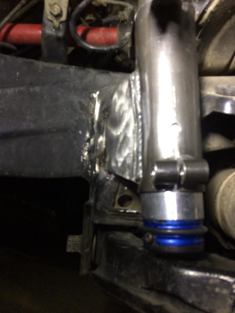

Nice! A couple of my customers running Blazeland Long Arms have done similar configurations and reported positive results as well.

I found a photo. Not a very good photo but you get the idea.
