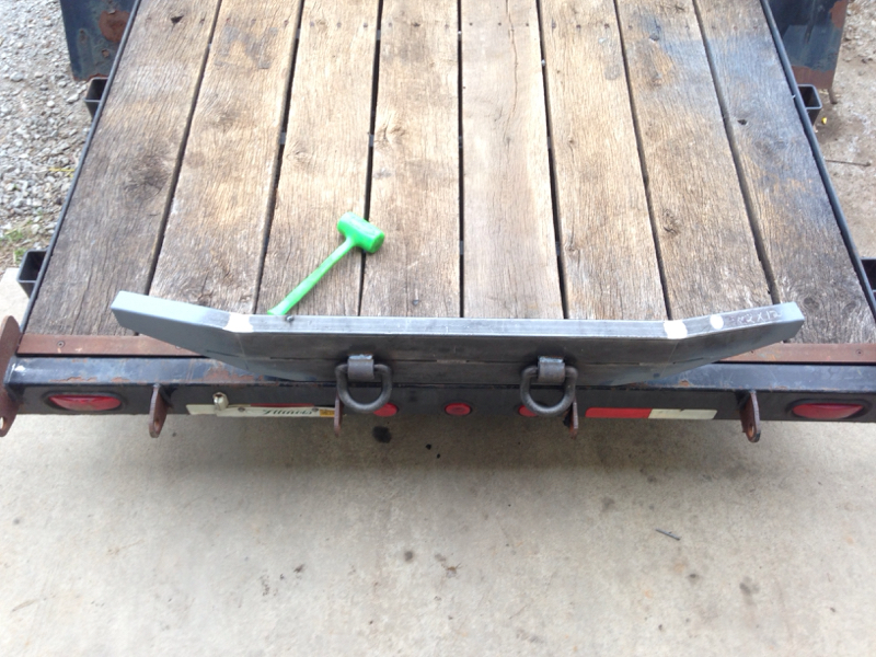

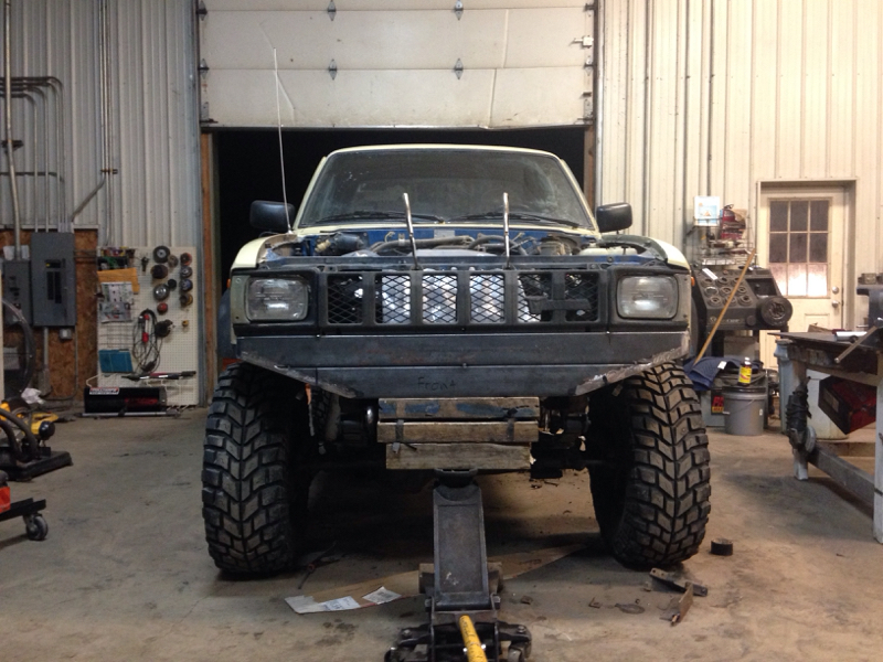

Built a bumper for my 82' pickup. Let me know what you think!
2 pieces of 2x4 tubing welded together. Cut a pie out of the bottom of both sides and bent the bottom pieces up to keep the nice edge of the tubing. Then notched the back to match the radius of the front of the truck. Capped the ends

That's a bumper that means business!
Good work!
