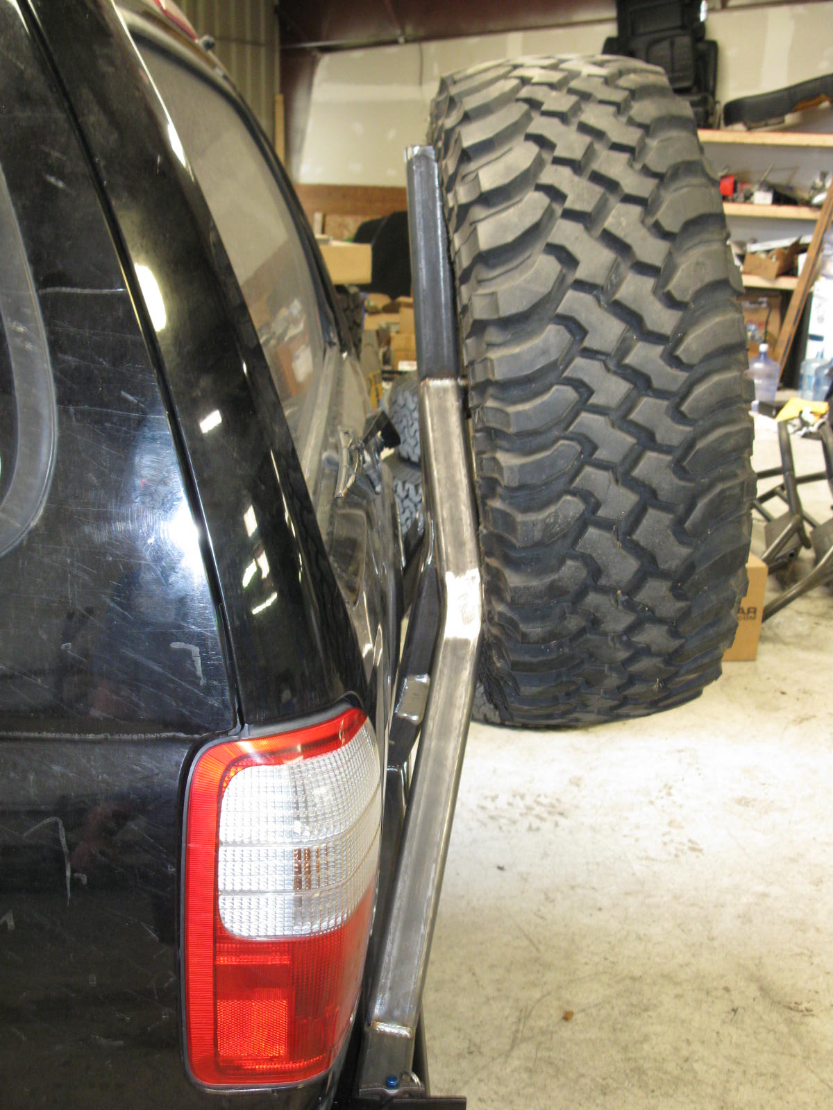

Got the latch yesterday and got motivated.
Then I got motivated and decided I hated the blue hard top. Oh, and I mounted and wired in the backup light to the reverse lights. Works killer.

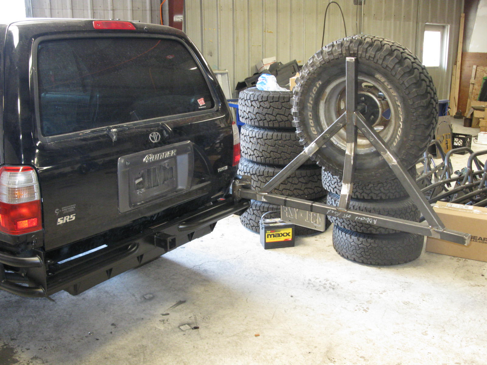

Just finished this one:
Attached Thumbnails 1st Gen 4runner bumper/tire carrier-img_0093.jpg   1st Gen 4runner bumper/tire carrier-img_0098.jpg   1st Gen 4runner bumper/tire carrier-img_0096.jpg

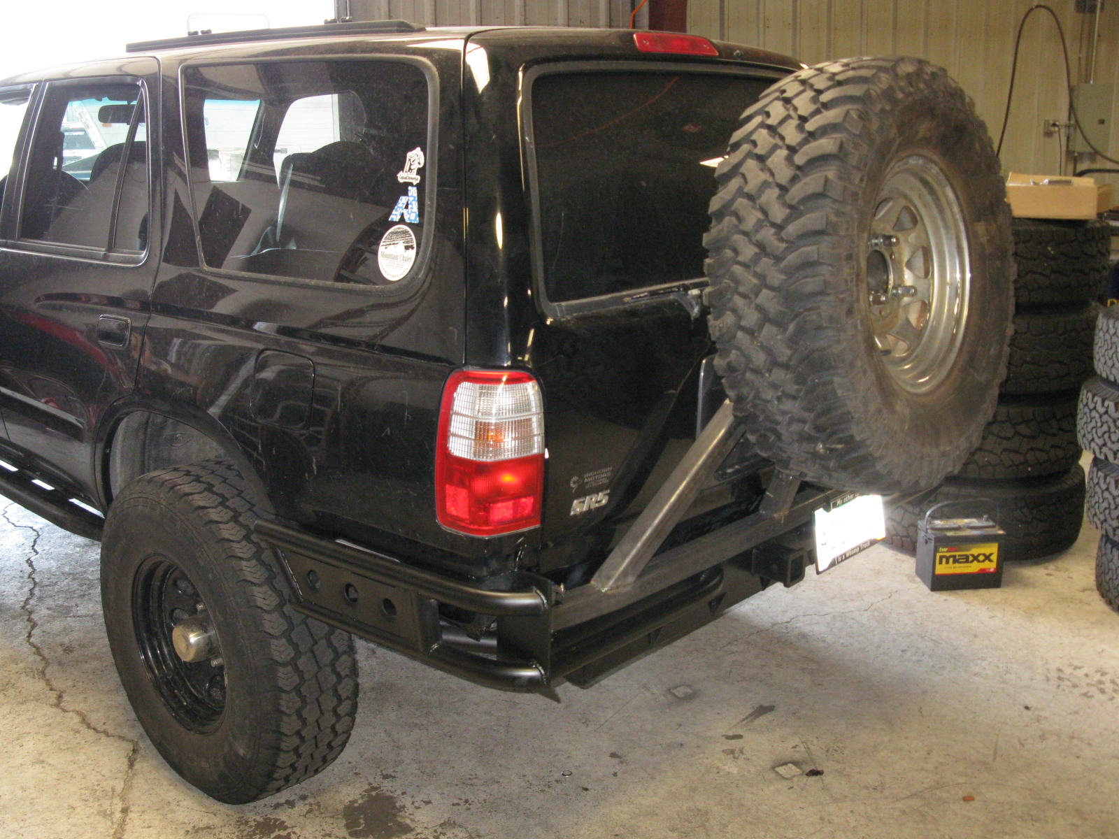

more.
Attached Thumbnails 1st Gen 4runner bumper/tire carrier-img_0099.jpg   1st Gen 4runner bumper/tire carrier-img_0097.jpg

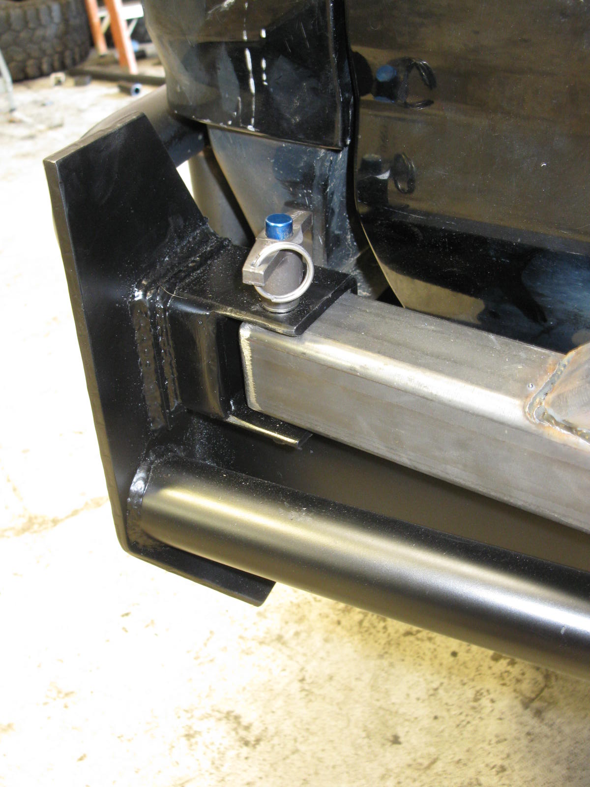

Good looking bumper you got there... Why the move away from the latch to the pin type locking mechanism? And it looks quite a bit stronger that way, not allowing any of the torquing force from the swing away arm to really reach the spindle. Thanks for the pics
Old Jul 11, 2013 | 12:31 PM
  #30
ScottyC's Avatar
Joined: Aug 2006
Posts: 3,477
From: Ft Collins, CO
Single sheer vs. dual sheer. The dual sheer is just stronger.
