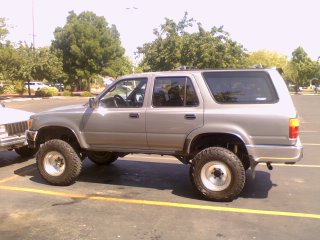

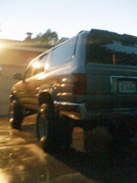

Here's a few new pictures since the 4" procomp lift coils and t-bar adjustments. Taken on my cell phone so excuse the quality. First pic was outside my work, second was in my drive way after a wash.
Attached Thumbnails Hostile's Profile-0426090001.jpg   Hostile's Profile-0426090004.jpg
