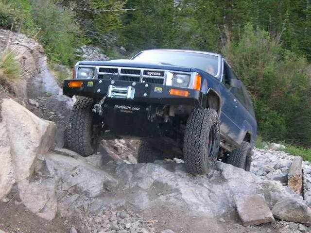

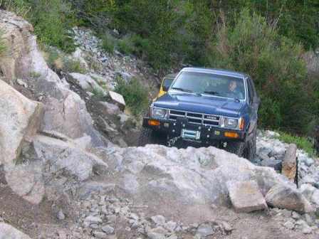

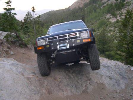

2006
Colorado
Montezuma Basin with my dad & his Rubicon:
July 2006
Going over Jaws 1 on Blanca Peak road. See and hear my idler arm bending as my passenger-side tire wobbles around.
Another video of Jaws 2 where you can hear my idler arm snap. Or you can watch the hi-lights of all of the road on a low-res WMV video (5.85MB, 3:37). Fortunately, I had a spare idler arm. Came home and ordered the Downey idler arm brace. We'll see how that holds up.
Blanca Peak Road: Jaws 1,
Jaws 2 approach,
Jaws 2
