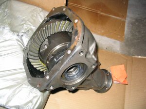

I broke a spider in the front this week and ruined my ring and pinion. My runner is sitting in the garage and will not work untill I replace the entire guts of the differential. I dropped the entire front drive train. The good news is that I have had the down time to install my 2 inch RB body lift, rebuild my winch and paint both bumpers. I am ordering a Detroit TrueTrac ($334.99) and 4.88 Gunuine Gears ($310) from Drivetrain Warehouse today or tomorrow. Does any one know of any better prices or places to get this stuff from?

Ok I went with a whole new 7.5 differential with the truetrac and Yukon 4.10 gears. I didn't want to rebuild my rear axle cause that would take alot more cash:pat: The pumkin comes complete all I need to do is pop on my old output shaft and fill it up with fluid. In all actuality I didn't ever have a problem with low end torque with the factory 4.10. And after the 2lo mod I feel it it unessesarry to regear. This truck is suppose to be my dailly driver so regearing will decrease the performance of the vehicle at highway speeds. So I guess the only thing I have to do with the rear end is fill it with Mobil 1. Will post pic of my runner tonight:alien:
